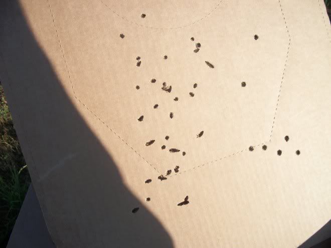

    Well..... I got my new baybee in my hot little hands this past Friday.
    Fit and finish is awesome... particularly for a Century build. My underfolder AKM is a Century... and while fit and finish are just fine, its parkerizing was THIN and spotty, not unlike Lindsay Lohan. (However, a baked-on coat of enamel later, it's just fine. The jury's still out on Ms Lohan.)
    I disassembled and cleaned it thoroughly. I had an extra set of US-made Bulgarian-style handguards and pistol grip, so I swapped out the Tapco stuff that came on it. The buttstock's got to GO - I didn't like the way it angles up, plus it's a bit too long. I'm accustomed to Warsaw-length stocks on AK's. Plus, the way it curves up, I figured it'd screw with cheek weld. A new one shall arrive tomorrow evening.
    I took it to the range. With me were a couple boxes of Wolf 60gr. and a couple boxes Silver bear 60gr. On the way, there was a conveniently-timed gun show so I got a Promag 30rd mag.
    Recoil was soft and pleasant. No muzzle rise - that comp on the end does its job well.
    Problem:
    Keyholing.... not every round, and both brands did it.
    Me and my buddy Schadenfreud have done some extensive studying on the net, and surprise surprise, it looks like Century used 5.56mm barrels on earlier Tantal builds, and maybe 74 builds too!
    So, I did the little test of sticking a 5.45 round into the muzzle.... There's maybe 1/4 inch of copper between the brass and muzzle.... but in a known 5.56 barrel it goes in all the way to the brass.
    SO, that rules THAT out! (whew!)
    One hypothesis is that my 74 just doesn't like the 60 grain bullet... from what I can tell, it was designed for a 52 grain bullet, but dayumm, can it make THAT much of a difference?
    Ideas? Opinions?

    I almost forgot - once, it failed to eject.
    The bolt carrier caught the empty. Have you EVER heard of an AK doing this???
    Plus, the Promag doesn't latch up. The Bulgarian that came with it plus an East German fit nicely, but the PMag doesn't.

    Check the flash hider. I've heard of bullets striking it on the way out the barrel and causing major accuracy issues with the '74 style flash hider.

    I had purchased a polish tantal from century and it keyholed like crazy. Not a prob if you are plinking cans or watermelons, but a bit annoying when trying to be at all accurate on paper. Tried to get century to make it right, but they sent it back to me. I guess they cleaned it alittle? No improvement. It would also fail to extract occasionally.(had to hammer an empty case out with a rod and wooden mallet every 100 or so rds)
    So i sold it for a loss and got a ak from tgi with an official chrome lined bulgarian barrel. They unfortunatly don't make these or sell these anymore.(tgi)
    Now i have a great shooting ak74 that has had no malfuntions whatsoever!!! I have shot almost a tin of ammo through it(about 1k) and it is very accurate at fifty yards and best of all..............the holes are round!
    I now refuse to buy century aks. I'm sure some are great but the way they handled their screwup irked me a bit. When i buy a gun, i want the correct caliber barrel on it. that is non negotiable.
    oh yes and the promags are awful! Go bulgarian or russian. It does make a difference!

    I would fire some rounds without the comp, that would tell you if it is hitting it. Also check the crown, maybe?

    I just remembered - we actually tried that.... no difference.
    At least it's a 5.45 barrel instead of a 5.56.
    I'm going to try some 52 grain bullets, and if that doesn't work, Cope's has a Bulgarian barrel, ready to install. I figure a Bulgy barrel in a Bulgy trunnion... maybe a minimum of difficulty?
    I have a buddy that's a damn fine smith, and he should be able to install it.
    I HAD thought of cutting my losses and selling it, but ******, I like that gun! Plus, it's in fine shape and very well built, apart from having a lousy bore. Even spending $125 on the barrel and having it installed, the total $$$ would still be waay less than a 74 built by a big name builder. Sure, it being a Century, it wouldn't have the resale value of the others, but I don't care because guns never leave my collection anymore.
    What do you think of my reasoning?

    Cat, I found with my CIA build that I get keyholing every so often myself. Haven't checked the bullet in the end of the barrel yet, but would think it would be like yours.
    I will have to try and remove the flash hider but suspect this will not be the culprit either. I suspect a barrel with the wrong rate of twist or something along them lines. I will have to try removing it today and see.
    Funny thing with mine is sometimes I get them allot and other times just a few. I have heard reports of them tumbling at 25-50 yards and not at 100 and beyond but this always sounded strange to me.
    Good luck keep us posted. The only way so far I figured out how to fix mine was I bought a Saiga and now shoot it almost exclusively. Man the Saiga is nice.

    I'm HOPING it's twist rate. Hey do me a favor - take your muzzle brake off and look at your rifling. Mine is present, but looks, well, weak.
    Quote Originally Posted by Rigrat View Post
    That's exactly what mine appeared to be doing at the range. I didn't mention it in my original post because it sounded plain weird.
