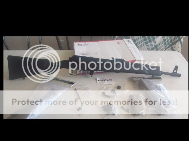

    Today, my son and I tackled the Saiga conversion. After a ton of internet research, and some help from Rigrat and zero; we got it done .
    It took a total of 5 hrs, but we took our time. It wasn't really hard; the most difficult thing was trying to maneuver the BHO spring.

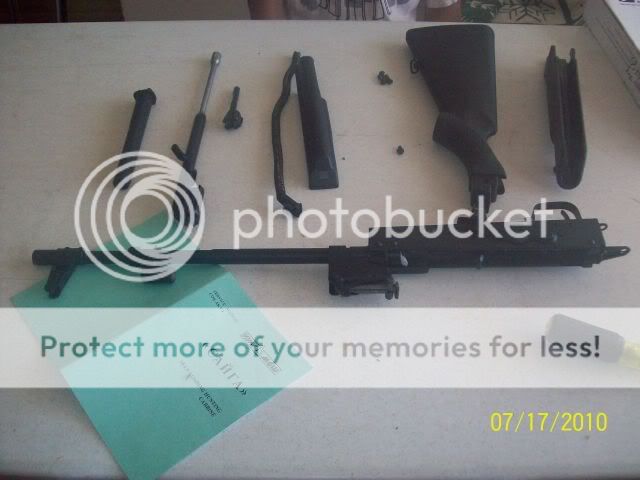

    Here is our beginning point; it was too hot in the shed, so we did it in the kitchen (mom was at grandma's, so we were okay )

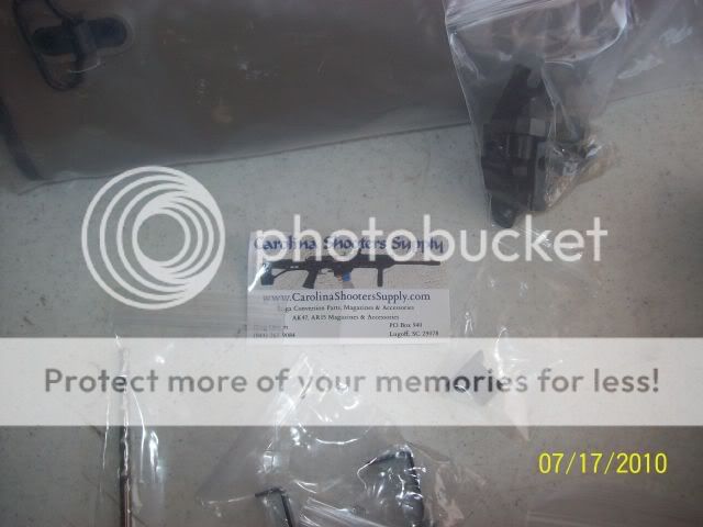

    I bought everything online, from Carolina Shooter's Supply
    We got it disassembled with relative ease

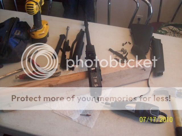

    Then we broke out the power tools

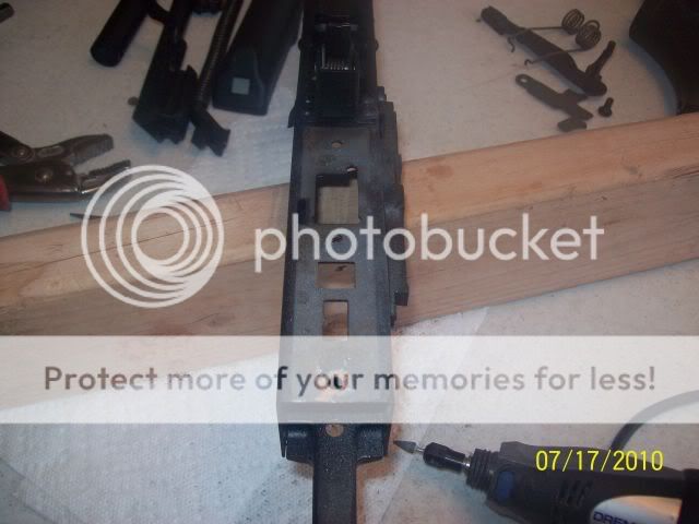

    Here's a closeup after we removed the trigger plate. I was pleased to find the trigger hole ready to go for the new FCG

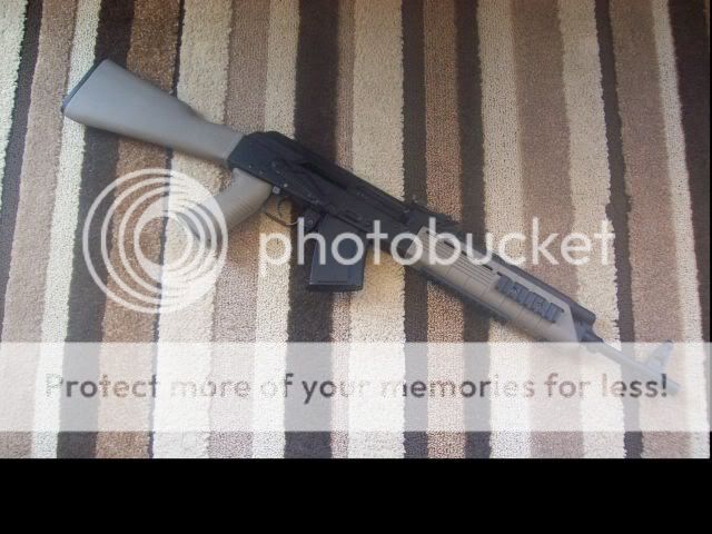

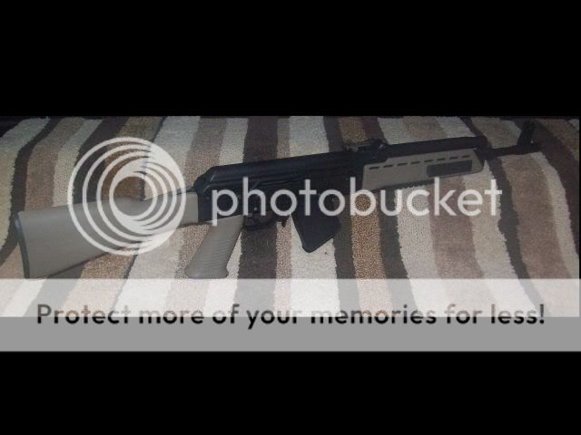

    I was initially going to go with a collapsible, AR style stock, but after some research, I realized that the AK stock is no longer than the AR stock fully collapsed, so I went with the standard AK stock. I also added a Tapco tri-rail handguard. With the addition of the handguard, I am able to use com-block AK mags and remain 922 compliant.
    I did have to file down the mag catch a little, to accommodate the AK mags, but neglected to get pictures I also modified the stock Saiga mag, so I can still use it.
    All in all; I'm pretty pleased with it

    Hey Zacii, did you drill the rivets? Or did you dremel the head off of them? I used the dremel myself and never touched my drill to mine. Was really easy that way and only took about 30 minutes to get the trigger-guard and plate off.

    I just ground them off with the Dremel, and then punched them out.
