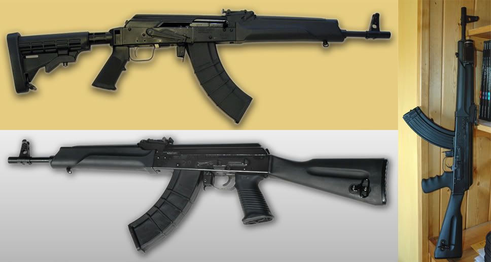

    Pictured is my first 7.62 Saiga that underwent a couple stages of transformation. First (top) was a tapco T6 and USA mag. It was legal with high capacity and adjustable LOP. The pistol grip was held on to the collapsible stock with a sheetrock screw...not AK standards.
    Second (bottom) was a FCG relocation, tapco saw grip, kvar stock and USA mags. HUGE improvement with the new FCG. The Warsaw length stock improved balance as well.
    Currently (right) comblock mags w/bullet guide, USA gas piston, performance mainspring and Hogue grip, it wears a TLR-1 Streamlight at night sometimes too. I like the Hogue grip feel and the lighter mainspring has been fine so far, faster trigger. The comblock mags are cheap and reliable with minor adjustments.
    I had a lot of fun trying things out and seeing what worked good etc. The reason I picked up a Saiga in the first place was to work on it, and as you probably already know they are quality affordable "sleeper" AK's.
    Second pic is my 5.45. I ran her stock a hundred + rounds before conversion to make sure everything was OK under warranty and then wrenched on it. I really like the Ultimak with red dot...much faster acquisition. Currently I'm putting a Bulgy 74 break on. At .13 a round it is one fun practice AK.
