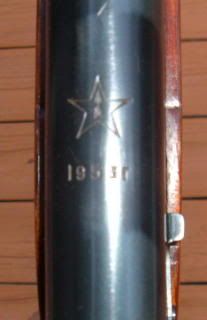

    Out of curiosity what markings are on the guns. Do you have a photo of the stamped markings on the rifle receivers?
    Does it look like this?
