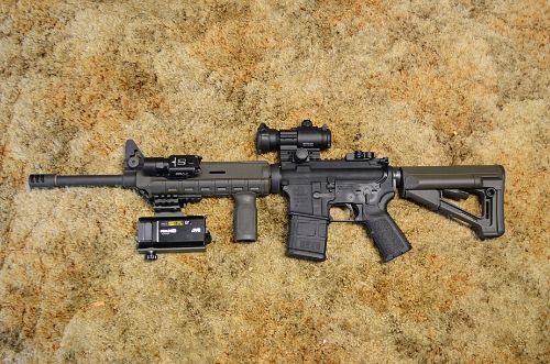

    Here it is, it's on muzzle end of the gun:

    Most of you likely know that I have a hog hunt coming up in about 3 weeks. I want to record as much of the 'fun' as reasonable so I've been looking at ways to record the major events.
    I think most people's first thought would be a GoPro, but I've learned what should have been obvious to me, 'action' cams have a very wide angle lens, anywhere from 120° to a whopping 170°. These cameras have these wide angle lens to capture action up close, for example, mounted on the end of a surfboard or kayak, they have to capture the person lterally from head to toe, and that's where they really shine.
    However, as the range increases these wide angle lens become a disadvantage. As the range grows, the lens takes in so much area, specific 'targets' or objects become quite small and it doesn't take very much range before an object of interest is unrecognizable or at least difficult to see.
    I tried my Tachyon HD gun camera on a couple of guns and was a little disappointed in the results. Like all action cams, it's best is up close - like clearing a room. But if you look down the street a block or so, people become too small to recognize. And remember too, these cameras have no zoom. Why do you think the non-action camcorders have 30X and more zoom capability? To catch the action when it's far away, obviously - like a pig 25 yards away.
    Rather than continue in abstract descriptions, let me do some number crunching for you and bring some perspective to the problem. Let's take a pig that's 3 feet from nose to rear end. That may not sound like a big pig, but pull out a yardstick and you'll see that's a pretty good sized pig! Let's say the pig is 25 yards away and we have an action cam with a 120° angle lens. The question is, how many feet does the camera see, i.e. width, at a distance of 25 yards?
    Well, the math says it would see 260 feet at 25 yards! That's huge! So the three foot pig is 1.15% of the total pic in just one axis. And there you have the problem - at 25 yards, the pig is waaay t0o small.
    Realizing 'action' cams were not the answer, I started looking for a suitable camera. I wanted true 1080p HD, at least 20X optical zoom, as small as I could find, and a subtle but important feature 'zoom memory', i.e. if you turn the camera off, when you power it back up, it will automatical be at or go to the previous zoom. After a lot of looking and researching, I found a JVC GX V500 - it looked perfect; it was significantly smaller than anything else and had all the features, and the best feature was it was only $229 from Walmart (online).
    Now I had to come up with a way to mount it. I wanted to mount it upside down to get a tight mount and use my video editor to upright it - that would be easy. The problem with upside down is the LCD viewscreen would open on the right side of the gun and that's the wrong side for a right handed shooter. So that was out.

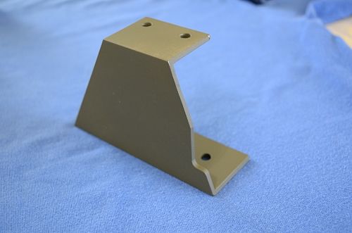

    I'd have to design and build a mount. I wanted one that would give as much protection to the camera as practical, allow access to the zoom control, and to the lens shutter open and close switch. It took three generations to come up with this. This is it after it had been sand blasted and painted with a non-reflective olive drab paint to match (pretty close anyway) the olive drab on my AR.
    The little notch is a relief cut to allow access to the shutter switch - you'll see that better in another pic:

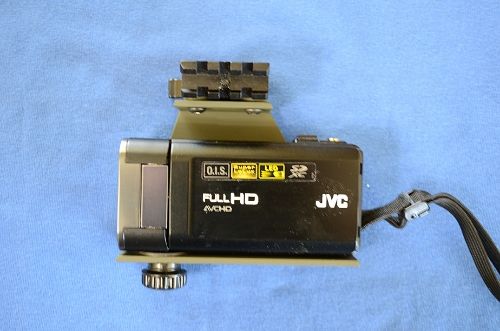

    And here it is with the small QD rail grabber and camera all mounted:

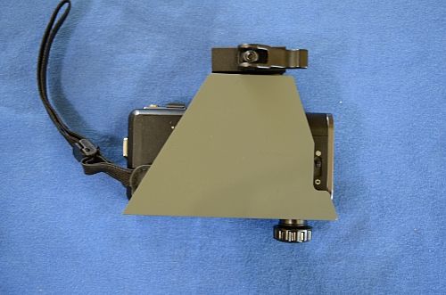

    And the back side and the reason for the notch:
