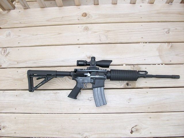

    Assembling an AR from parts is not that high tech.
    Cross breed assembled from parts left over from other projects
    Voodoo barrel
    Huldra(Adams Arms) gas piston block and rod Bolt Carrier Group
    Knight tactical upper receiver
    Panther arms lower
    CMMG kit for the lower
    Magpul stock generic buffer tube with heavy buffer
    Old colt fore grip modified to fit gas piston rod
    Mid level scope that was laying around unemployed
    Shoots great but if you added it all up parts would cost more than buying a good one. Still not really a build more like assemble .
    Here is what can happen when an AR upper is messed with with out proper blocks being used. extreme case
