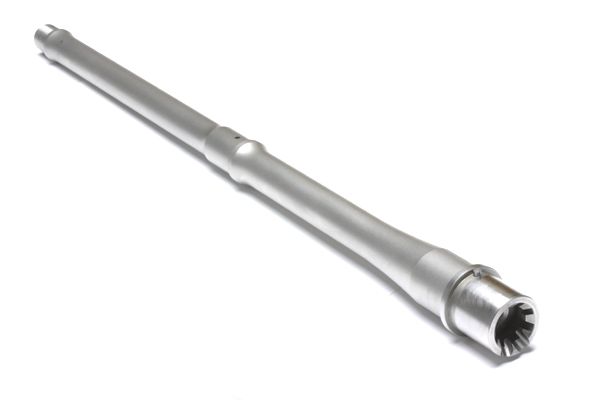

    The barrel is from Wilson Combat - Tactical Lightweight, 16", 1-8 Twist

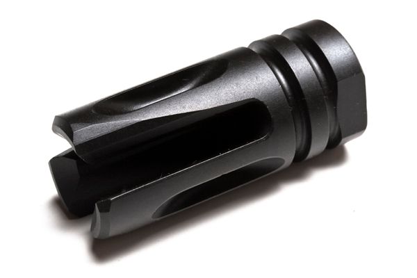

    The flash hider is a Wilson Combat Accu-Tac Flash Hider, .30 Caliber:

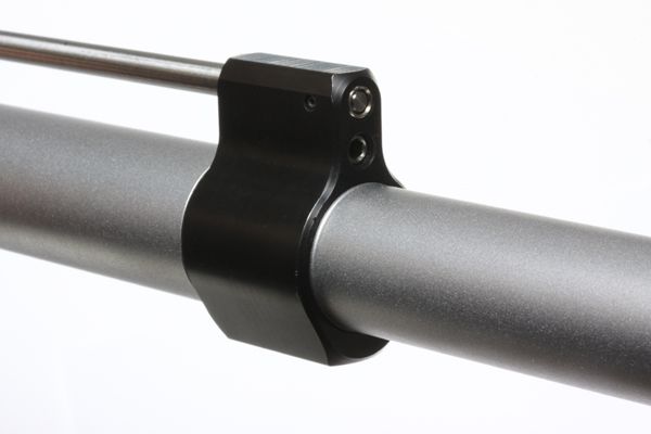

    And since I would be using a Wilson Combat barrel, it makes sense to use their gas block as well.
    Since this will be for a 300 BO and I want it to cycle 110 gr to 220 gr loads, notice the barrel has a 1:8 twist so it should stabilize the heaver rounds, and knowing that unsuppressed ARs tend to not cycle the 220 gr loads, I decided to try an adjustable gas block:
    I am hopeful that some setting will let the gun cycle with the heavier loads, but I kinda doubt it will. But even if it doesn't, it will still give me the option to eliminate 'over-gassing' and and I can tune the rifle action to the load. Because the adjustable gas block sets the tube a bit higher, it comes with a straight gas tube instead of the bent version and it's already installed in the gas block.

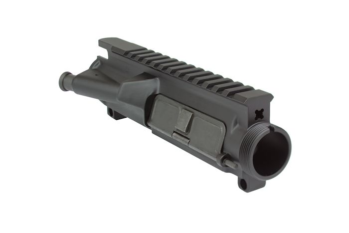

    JD Machine has an upper that comes with the ejection port cover and forward assist assembly and they are already installed.

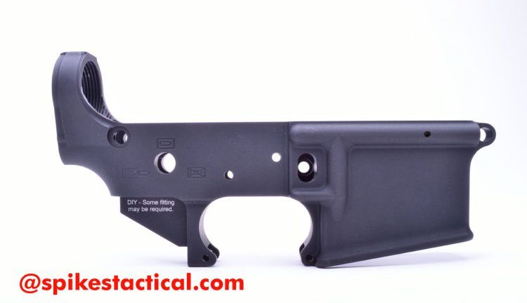

    I bought a Spike's lower from a local gunshop because they had one in stock:

    Good looking rifle. I like I the hand guard especially. I take it the gas block requires a Allen wrench to adjust?

    ...I take it the gas block requires a Allen wrench to adjust?
    Yeah, it does. It has a set screw that adjusts the gas, and a locking set screw behind that one to lock it in place. I really don't like that but that's what it is.
    That wasn't my first choice. My first choice was one from Syrac that has detents to hold the adjustment screw setting and Spike's also makes one with a detent. I'll probably replace the Wilson with one of these.

    There's really no reason for you to be adjusting the gas on the 300, so I'd personally remove that option. Other than that, it's a great setup.
    I've shot a 220 gr BO in a 16" barrel (no suppressor) and it would not come close to operating the bolt and ejecting the case. I've heard of others experiencing the same thing.
    I am hopeful that the adj. gas block will let a bit more gas flow but I think that's just wishful thinking; I think all adjustable gas blocks do is reduce gas flow/pressure.
    As far as I know, the only way to deal with the problem is to increase the gas pressure or tune the buffer and buffer spring to the 220 gr load, then the gun is too gassy for the 110 gr.
    Is there another approach to this problem???

    Sorry man, I came back to edit my post then for sidetracked. What I meant to say, was that the adjustable gas block won't do you any good for what you hope it will.
    A normal gas block opening is larger than the gas port in the barrel. So, there's no way that it will allow more gas to pass through.
    Mine will cycle 220 subs, but barely. What I'd do is just keep a lighter buffer with me if it was that important. I'm not sure what weight WC suggests wih that barrel, but I'd run that normally then carry the lighter one in my bag. Or, you might want to try the Vltor A5. It's a LOT more tolerant than a carbine RE and buffer.

    ...What I meant to say, was that the adjustable gas block won't do you any good for what you hope it will.
    Well, I kinda thought that going in, but I also had it bouncing around in my mind to open up the gas port in the barrel just a bit. Then with the adjustable gas block I should be able to switch by just turning a screw.
    ...Mine will cycle 220 subs, but barely. What I'd do is just keep a lighter buffer with me if it was that important. I'm not sure what weight WC suggests with that barrel, but I'd run that normally then carry the lighter one in my bag.
    That's a good thought too. Hmmm.....hmmm....What about running a lighter buffer. That would make the gun a bit lighter, which for my purposes is a good thing and then to shoot the 110 grs, turn the gas down. I may have to play with that!

    I'm working on a way to make the adjustable block a two or three indexed selection. One for subs and one for supers.
