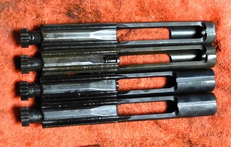

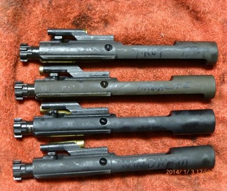

    I took these four BCGs to the range today: Armalite, Troy Industries, BCM, and a Windham Weaponry. I fired 110 gr and 125 gr rounds with each of the BCGs. You guys are right on!
    The Armalite (second from the top in the pics) locked back every time, although I sense it may be somewhat marginal. The Troy (top one in the pics) locked back most of the time with the 110 gr but didn't much like the 125 gr. The BCM and Windham didn't lock back at all.
    BTW, the upper is made by JD Machine.
    Here are pics of the four BCGs:
    None would even start to lock back with subsonic 220 gr and wouldn't even eject the cases.
    The weights are:
    Windham..11.6 oz
    BCM........11.7 oz
    Armalite...10.9 oz
    Troy........11.0 oz
    There's no more than 0.8 oz difference in weight from the lightest, Armalite, to the heaviest, BCM.
    Are we thinking eight tens of an ounce is the problem, or is there something else?
    Eight tenths of an ounce (less than an ounce) doesn't seem like enough to make a difference???
    Hmmm, you know what - it looks to me like all that extra metal at the rear of the BCGs should weigh more than 0.8 oz, but that's what the scale said. I'm gonna weigh them again, that just doesn't look right. Well, I got exactly the same thing the second time - it just looks like there's more metal there than 0.8 oz.
    So maybe the 'right' bolt carrier will fix some of the problem, but that still leaves the 220 gn cycling problem.
    Thoughts???
