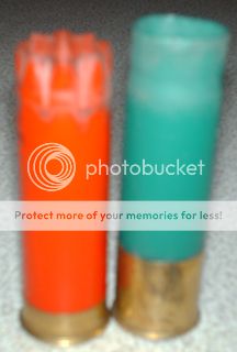

    I though high brass and low brass meant the length of the brass cap on the end of the shell that holds the primer.
    Like this:
    Glock 19 • Glock 26 • Springfield Armory XDS .45 • Kahr CM9 • S&W Shield 9MM
    GeorgiaCarry.org Member
    VIP Member Array StormRhydr's Avatar
    Jun 2013
    Music City, USA
    5,584
    Quote Originally Posted by colding View Post
    Like this:
    Well, yes, it does. However, when folks spoke of "High Brass"/"Low Brass" shells, they were talking about the powder charge in them.
    Ie Fred says to Bill "I threw up on some ducks, and was loaded with some good Remington High Brass shells..." Bill says to Fred: "Man, all I had were those no account low brass Mohawk specials I picked up at Walmart! I could hardly knock a feather loose."
    Like this:
    Very true...
    High Brass is not necessarily an indicator of the load. Higher brass is used, sometimes, for the purpose of reinforcing a weaker plastic, or paper hull. I have seen low brass, 12 Gauge, 1-1/4 oz 3-1/2 dram loads. I have seen High Brass on 12 Gauge, 1 oz, 2-3/4 dram loads.
