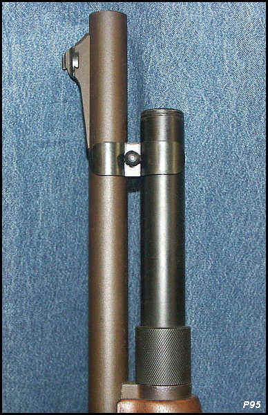

    Added ext'n to mine without too much grief. Not shown in the pic is bracing clamp I fitted later - which nicely secures end of extension to barrel. Without it a sharp knock could cause problems.

    Just to show mine closer up, quick pic, and with the addition of the bracing clip.
    I bought the ext'n from another guy used so forget its origin right now, and maybe dr_cmg can remind me of the source where I got the bracing clip - also forgotten for now! Does reduce the vulnerability of the extra mag length.
    Chris, your wish is my command. TAC STAR BARREL MAGAZINE CLAMP 12GA MOSSBERG, REMINGTON, WINCHESTER
