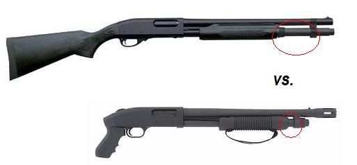

    How can I get a good light on this, without having to buy this

    the problem Im seeing (maybe Im wrong) is that on alot of the magazine tube mounted lights, the shotguns (such as Ramrod's) have plenty empty space on the magazine tube. On the mossberg tactical cruiser and other 18.5in barrel mossbergs, it seems like there is very little room for mounting much of anything
    see what I mean?

    I see. What you could do is find a mount that is close and cut it down so that it fits besides that you might have to get a different forgrip with rails and attach a light that way.

    I prefer the picatinny rail type forearm mount myself instead of the coiled cord pressure switch or the tube mount thumb activated light. That being said I am still using the tube mount light while looking at various picatinny rail forends. As far as I can see I would only be mounting a white light on my SG so there is a lot of wasted rail on the forearms that I have looked at. I am looking at just attaching a short piece of rail to my existing plastic forearm, but it is down the list on my priorities right now.

    That sounds ideal because I really like the factory mossberg forearm with the strap on it. Would it be possible to just buy a piece of picatinny rail, attach it to the forearm with a couple screws, put a light mount on it, and call it done? Would that stand up to 12 Guage recoil?
    I haven't done this, but you made me think about it.
    I have the same forearm that you do (I have the SP tactical w/stock), I removed the strap - and found it had just been screwed into the plastic with pilot holes.
    Why not get something like this:
    AR15 parts, rifles, magazines, receivers, kits: HANDGUARD RAIL WITH COVERS, ACCESSORIES
    Then go down to the hardware store and buy some suitable screws to attach it to one side of the existing forearm?
