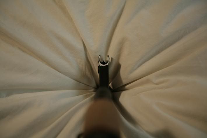

    Sorry for splitting this into two posts, but it would be absurdly long if all in one.
    Just went on a shopping spree and picked up some goodies for my 870 and my WASR.
    Three quick thoughts:
    1) Your paint is a tad on the grainy side- it won't grab light as effectively as high gloss, but it will be inclined to grab grime. Try mixing a nickle sized dot of Devcon 2 ton epoxy with 2 drops of testors High Gloss white. Extremely oil/solvent resistant and visible in any light.
    2) If you open your rear notch up with a 1/8" round file, you'll be able to use the more visible front post more effectively.
    3) Grope your rifle. WASRs have the bad habit of having sharp edges on the safety lever and gas tube retaining latch that can chew your hand up when using a reach over/under to charge after a mag change. A Dremel or a small file to knock edges off, and a dab of cold blue will make it even more user friendly.
    Go ahead and stick that Phantom on- that goes a good way towards making it a useful carbine rather than a noise maker.

    Well the paint is really more of umm..... white out
    I didn't put it on there expecting it to be durable and stay forever.
    Thanks for the idea about the epoxy! Might have to try that out
    Im waiting to put the Phantom on, just need to get around to it. My slant brake is stuck on there (tack welded I believe) and I just need to get around to taking it to a gunsmith. Already talked to one that said he could do it in about an hour or so (is this too much time do you think by the way?)
