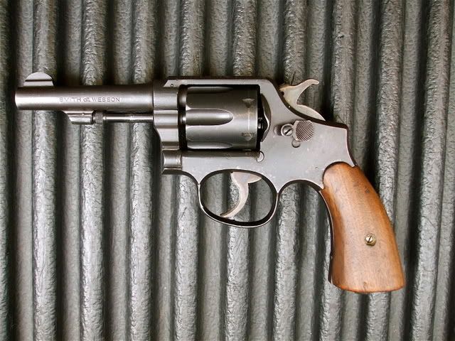

    Here is an example of the Military & Police gone to war, a World War II Victory Model with the contract specified wartime finish and plain wooden grips. This revolver is likely only a couple of years older than yours is.
    I'm not recommending that you do the same but I've fired .38 Special +P 158 grain factory loads in this Victory Model and have seen a lawman use Winchester +P 110 grain JHPs in the Victory Model he carried as a duty weapon. The revolvers appeared to be none the worse for it.
