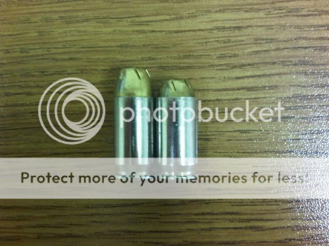

    My Mk40's slide slams home REALLY hard, where as my two .45's don't. The Mk40, I've noitced doesn't seem to setback the rounds. I use PDX1 in .40, the Ranger T's little brother. But it will start to SLIGHTLY peel back the copper on the tip. Hard to explain so I'm going to try to take a picture.
    Here is a good, either not chambered at all or very little
    And the one that's taken some abuse. Not noticable set-back though. If you look closely on the tips, it almost looks like the bullet is starting to expand.
    The Ranger T's I have in .45 do not do this. But again, the recoil springs on both my .45's don't have near the same tension of my Mk40.
