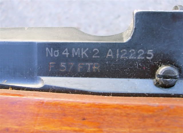

    I thought it was dated from 1958 but, upon inspecting it last night, found it is dated from 1957. I'm a '57 model so we're the same age.

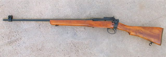

    Some "before" photos are posted here. Later, some "after" photos will be posted.
    Here it is with the ugly cut-down stock, stained some orang-y color and polyurethaned, all slick and snotty.
    Look Ma, no import marks! The post-World War II produced No. 4 Mark 2's aren't so common over here anyway and ones not having import marks are even less so.

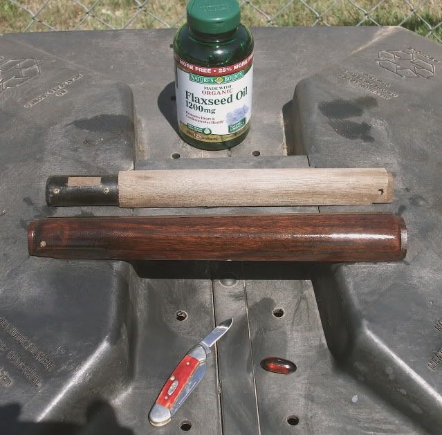

    This stock set is a sickly gray hue. When wiped with an alcohol damped cloth though it turns a lovely warm brown. I think the oil finish will be just right without any staining.
    I'm off to the store now to get some linseed oil. Raw linseed oil is sometimes tough to find. It is otherwise known as flaxseed oil and may be found in health food stores if unavailable elsewhere.
    14,434
    While I'm mixin' and matchin' my "tacti-cool camo paint schemes" I can give a sneak preview of the difference made by an application of the raw linseed oil. I just laid the hand guard out on my wife's black compost bin and allowed it to warm in the 91F sun then applied the oil.
    It's seen here just after I finished hand rubbing it using two fingers. No stain was used. The only place in town that I could locate raw linseed oil was on the health remedy shelf of the local Alco. As a health supplement it is known as flaxseed oil which is nothing more a refined food-grade raw linseed oil. Same thing. Stuff's great! One capsule, split across the end is enough to cover the hand guard including a healthy coat to its underside and makes a good applicator if one takes care not to squeeze it too hard. Leave it to lie in the sun for 15 minutes then wipe off all you can with a cloth.
    I'll allow it to cure overnight before applying a second coat.
    Compare the oiled rear hand guard with the unfinished front hand guard. The hue looks exactly the same as that on both my Krag Jorgensen from 1894 and Rock Island 1903 Springfield from 1913. Both still have their original stocks. I thought it looked a bit reddish for a proper Enfield stock. Most of the No 4 Mark 2 stocks found on internet examples of the rifles are quite blond. An internet search of several sites that give data the original stock finish used for Enfields including the No. 4 Mk 2 finds that the Brits used ... raw linseed oil.

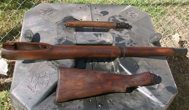

    15 minutes after the first coat, most oil had soaked into the thirsty wood in the hot sun as evidenced by the whitish appearance behind the bottom of the wrist of the stock.
    14,434
    24 Hours Later
    Here's the second coat after it had soaked in for about 15 minutes and just before I wiped off the excess. The morning after the second coat was applied, the wood was still tacky to the touch so we'll wait a few days until it hardens some more.
    The front handguard was of some different species of wood from the rest of the stock set. Probably should strip it off and attempt to stain it to match. I imagine that rifles in service were commonly seen with off color wood components so am going to leave it alone for now.
    Action area, barrel channel and all other interior areas were treated to an extra helping of oil to help seal the wood. These will just stay sticky/tacky for a while but will finally cure.
    Forgot to mention that before oiling, I relieved the stock a bit where the barrel rests out near the fore end tip in an effort to see if an accuracy improvement may be gained. If not, then I'll fix a slice of business card in place there to see if pressure helps accuracy.
    It is tempting to alternately sand and oil the stock which has a dab of interesting figure. One can achieve a really deep appearance and shiny finish with careful attention to sanding with fine grit paper. I've done sporter stocks like that and love the results. I have an exhibition grade black walnut classically styled sporter stock for an '03 Springfield that will be a knock-out when finished.
    I'm resisting the temptation to guild the lily so am trying to make this stock look arsenal original. Seems too dark to me but that is just the way the wood took the oil.
