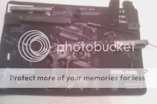

    I decided to try to install a short trigger in my PT1911. I ordered a short, black trigger from Brownell's, from Harrison Custom.
    I really didn't know what to expect; just dived right in
    I disassembled the gun beyond a regular field strip, something I haven't ever done...
    So far, so good. The ambidextrous safety, which has given the PT1911 a bad rap for falling out or breaking, was actually quite the pain to remove. I really had to work it back and forth for about 10 minutes, before it came free.
    A shot of the triggers, the stock one from Taurus is on the top:
    You'll notice that the bar that is attached behind the trigger (don't know the technical name, sorry) is larger than the Taurus one. I didn't know that would be a big deal.
    I was unable to get a decent pic of the internals of the frame. But, the channel in which the trigger bar/strut/truss thing is supposed to slide, was not cut straight. I don't know if this is a Taurus thing, or just a general thing. There was a hump, or peak, right in the center of the channel, as it dived into the trigger opening in the frame. I'll try a pic, tomorrow.
    Anyhow, the smaller bar on the stock trigger allowed the assembly to move up and down a bit, which let it get past the bend in the channel.
    I also noted, that the replacement trigger is ever so slightly wider and taller, than the Taurus one.
    I'm too tired, and it's too late to break out the Dremel, so I bagged it for tonight:
    I apologize for crummy phone pics, and a disgustingly dirty 1911
    This pistol hasn't ever malfunctioned on me, I just wanted to try to improve the length of pull for my small hands.

    I only know this from watching Youtube vids, but apparently there are "drop in" aftermarket parts and "fitted parts".
    Sounds like you might have gotten a fitted part that may need some stone work.

    Welcome to the world of amateur gunsmithing. The subtitle might read "why gunsmiths don't build custom guns on Taurus platforms."
    I would look closely at other trigger options and make calls before I used a Dremel on your frame*. I've never built a 1911 from the ground up, but your aftermarket trigger bow looks normal and the Taurus one doesn't. Note the bump in the Taurus trigger bow is about the same top-to-bottom dimension of your replacement trigger bow... the latter will have less top-bottom play if it rides in a properly dimensioned frame.

    Yeah, I expected that I would have to do a bit of fitting.
    I'm not going to take the Dremel to the frame, I'm going to grind the trigger bow a bit so it will slide into the channel.

    Rather than use the Dremel on the trigger bow use a very fine grit stone such as a hard Arkansas stone to thin out the trigger bow. The stone will help keep both sides parallel and will not remove too much material too fast. It will take a bit longer but will insure a better fit.

    You may run into a problem with the grip safety working also. This is not a job for somone without 1911 experience. The bow must be bent properly to set overtravel. A 1911 trigger job is not easily done.

    1. The Harrison trigger is designed to be "fit" gun by gun. You work the trigger with a fine cut file to fit the trigger opening.
    2. It is not uncommon to "dress" the bow for a slip fit but "I" have never seen one that needed reduced that much. Are there forward travel tabs just behind the front shoulder of the bow? If not the narrow channel of the frame may be Taurus's way of shortening the reset but not normal. I am guessing on this, just a thought
    3. As xpertz1 stated you may need to re-fit the GS. They some times come up a few thousands off requiring you to peen for length or bend an outbound bump/tab in the back of the bow if too short or remove some from the nose of the GS if too long.
    4. The GS/trigger bow also affect dis-connector timing as to sear release...VERY important to check and have operating correctly...did I mention dis-connector timing is critical to safety...by the way make darn sure the dis-connector is properly timed...
    It's fun to work on your own 1911 but please remember; the GS, TS, sear, dis-connector, hammer and trigger work as a "unit" for all practical intent and purpose in a 1911...THEY MUST ALL be correctly fitted as a unit to maintain safety and function. Take your time, get a manual and ask questions. I recommend the 1911 forum for a great store of information.

    The Taurus trigger bow has tabs on the front. The Harrison does not.

    I've been reading this a lot on 1911 forums, the PT1911s seem to be non-standard on many of their parts.
    I've installed 5 of John's "Extreme Service" triggers in my Colt's, S.A. Professional and my Thunder Ranch, none needed work on the stirrup. As mentioned, they are a fitted part, but the only fitting needed usually, is on the top and bottom of the pad and the over-travel adjustment screw, on frames within spec.

    That Taurus trigger has pre-travel adjustment tabs at the front of the stirrup. These can be bent outward/forward to obtain the desired pre-travel. The thinner/narrower stirrup on the Taurus is typical of a lot of the lightweight target triggers on the market. I do know for sure that STI makes triggers with the pre-travel tabs and the narrower stirrups. There may be a few other manufacturers that make a similar product, too.
    Most trigger shoes on a lot of aftermarket triggers are oversized. This way, you can file the top and bottom as well as the sides to get a good fit in your particular frame.

    The Taurus 1911 has several proprietary parts/ They did that on purpose, as with the PT92 and other guns they have licensed. I wish they hadn't, but they did.
