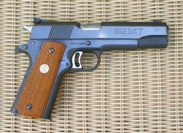

    Actually, the cartridge's chamber in an automatic is as far forward as that of a revolver, for all intents and purposes. The automatic also requires an area for a hammer or striker to operate, depending on which system the automatic uses to fire its cartridge. Consider the breech face of the automatic and the breech face of a revolver. They are located very closely to the same place in relation to the shooter's hand.
    Consider how much "gun" is behind the chamber of the familiar 5-inch 1911 design and where the shooter's hand is positioned in relation to that chamber when the gun is grasped for shooting.
    No compare the automatic above with a common mid-sized 4-inch revolver. When the triggers are pulled as far to the rear as they will go, where will one's finger be in relationship to the breech face on each of these?
    One can't give the advantage in barrel length to the automatic for its barrel also houses its chamber. The revolver's chamber is housed within its cylinder. So, the 1911 above has an effective barrel length of barely 4 inches even though it is stated to have a 5-inch barrel. The cylinder of the revolver is not considered a part of the barrel so the revolver above has what is closer to a true 4-inch barrel. The proper way to measure a revolver's barrel is from muzzle to cylinder face.

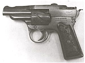

    The Zulaica automatic revolver was one of several European designs that bore a grudging resemblance to a semi-auto but the appearance really doesn't do much for me. It was of Spanish manufacture and was made sometime between World War I and World War II. It didn't "set the woods on fire" for sales, at least here in the States. It was still hammer fired. I think the Czechs had some sort of cheap revolver that looked similar about the same time.

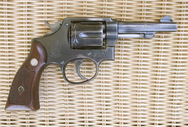

    Appearances are subjective. To many current handgun enthusiasts modern revolvers don't look "old West" at all. To me the modern double-action revolver, especially as rendered after World War II, looks efficient and business-like. The revolver was restyled in appearance and sighting equipment beginning about then. It was a restyle as the design and function remained unchanged. Smith & Wesson still makes the K-Frame Model 10 .38 Special to the same basic design that originated when the first K-Frame .38 Special was introduced in 1899.
    None of these .357 Magnum Smith & Wesson models look very "old West" in my view. They don't look like some sort of hermaphrodite like that sad Spanish revolver does either.
