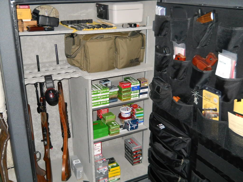

    I keep mine in the conditioned basement, however, during cold weather I use my wood burning stove and the basement gets cold. I had to remove the door frame to get that 880 lb. monster in. To be on the safe side, I use a Golden Rod heater (available at Cabela's, etc.) and a couple of desiccants.
    [IMG][/IMG]

    Quote Originally Posted by Dennis1209 View Post
    [IMG][/IMG]
    Thanks guys. All good points of view. I will consider bringing it inside if at all feasible. Its a big freakin basement so I should be able to find SOMEWHERE.
    Also, Dennis1209, what safe is that in your pic? It looks a lot like the one I am looking at (cabela/Liberty brand)
