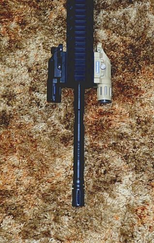

    The first problem is that not all long guns have a convenient way to mount a light. And remember we're talking about SD, night hunting, and competition - that covers a wide range of long gun types, needs, and applications. Bolt action rifles are probably the most challenging. I know guys that actually duct tape lights to their bolt rifles, and other rifles, e.g. lever action but that's a bit iffy and if not done right can damage the finish on the gun. Even ARs can have light mounting problems, esp. those with the round forends. Shotguns can be less problematic than rifle/carbines because the combination of a barrel and magazine tube and clamps offer some possibilities that aren't available on other guns, e.g. an integral clamp and rail as shown here:
    There are a couple of problems with that mount you should be aware of. One, it can mar the finish on your gun, as it did on this particular gun, and two, you can't field strip the gun without removing the clamp. Sometimes you can't access the screws to the clamp until you have removed the rail. The particular clamp shown in the pic above, is a Nordic clamp and bolt on rail. There are two clamping bolts on each side of the clamp and since there is a rail on one side (and there can be a rail on both sides, the rail(s) have to be removed to remove the clamps - all a great deal of inconvenience, esp. in the field.

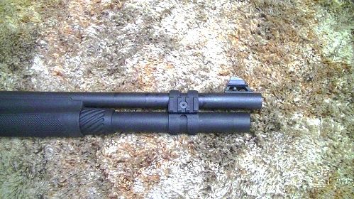

    So with regard to shotguns what about just a magazine tube clamp instead of a barrel & mag clamp? Well, it depends - you still have to remove the clamp to remove the barrel for cleaning or whatever - the barrel ring that encloses the mag tube won't slide past the clamp. I say it depends because if you can mount the clamp behind the barrel ring, the barrel can be removed. Or, if you can find a QD (Quick Disconnect) type mount that would make things easier.
    One last possibility is a barrel clamp. The clamp secures the light to the barrel alone and hence the barrel can be removed without removing the light or the clamp. However, now you're limited to mounting positions. E.g. you can orient the light to either side of the barrel, but not to the bottom of the barrel. So with a light on one side, you've got a wider package.

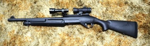

    I'll offer an alternative for some of the hard to mount guns. It's a method I use on specific guns and it's close to universal across the board - ARs, shotguns, and even bolt and lever guns. There is a few caveats however that I'll get to them shortly.Here it is on a Benelli Supernova Tactical shotgun:

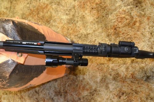

    And from the top:
    A little closer for the mount details:

    Although this allows a light to be mounted where there are almost no other alternatives, there are a number of things to be aware of and consider with this type of mount. Since this post is getting pretty long, I'll continue in the next post...

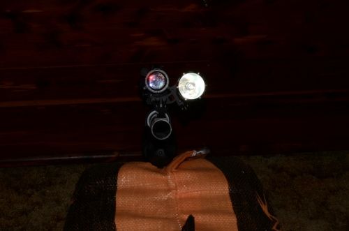

    Forward mounted lights have less of a barrel shadow problem because there's less barrel to cause a shadow, but it can still be in the way. Again, mounting the light further away from the barrel will help. Another option is available for forward side mounted lights and that is to use two lights, one on each side as shown here:
    That will minimize barrel shadow plus double your lighting power. But don't expect to be able to see twice as far - that only works for specific conditions.
