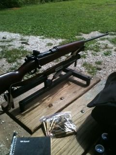

    This particular rifle was given to me by a friend who was a Marine Capt, and has been retired for 30 years. The stock was sporterized before it became mine.
    Using a handload of 47 grains of H380 under a Hornady 165 SP bullet, my goal was a relatively mild all purpose round to load up in bulk and have on hand for whatever was needed. I chose H380 because; #1, I had only a limited amount of IMR 4064 and 4831, and wanted to save it, and #2, I had never tried H380 and had a pound of it, so I thought it would be good knowledge to add to my library of load data.
    I also loaded 5 rounds with the same powder and charge with a 150 weight Sierra FP made for a 30-30, just to see how it would perform.

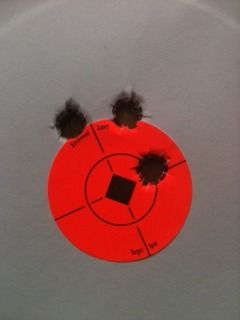

    Heres my grouping at 50 yards with the Hornady 165 SP loads.
    URL=http://s1183.photobucket.com/user/glockman10mm/media/photo_zpsd9b94fc7.jpg.html][/URL]
    The target is only a 1.5 inch dot, so with the very skinny front sight, I was happy with these results.

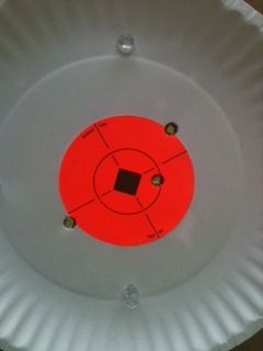

    Moving back to the 100 yard distance, once again iI was satisfied with the results using only military iron sights, and using a powder bullet combo not known for the best 30 06 accuracy. I used a 3 inch target at 100 yards, but surely this rifle has potential left in it.
    My target at 100 yards.

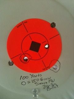

    I thought this would be a good time to try the rounds loaded with the 30-30 bullets, and see how they shot in comparison to the 165 grain Hornady SSP bullets. The circled rounds show the impact of the 30-30 bullets. My POI change between the two was negligible.
    Notice the difference in bullets used specifically for the 30-30 compared to standard rifle bullets such as the 165 grn SSP.
    I seated them both to the same depth.
    URL=http://s1183.photobucket.com/user/glockman10mm/media/photo_zps76257001.jpg.html][/URL]
    Extremely satisfied with the early results of this load testing, and concluding that this rifle has alot of potential, I decided to move on to another favorite rifle; the Marlin 1894P with 16 inch barrel and compact 4x Burris scope.

    All interesting, but I found the comparison of the FP .30-30 rounds with the 165 SPs particularly interesting. I think your results are pretty clear evidence that at decent rifle velocities, ballistic coefficient is a second-decimal place effect up to 100 yards, possibly more.

    Yes, I was quite pleased with the FP bullets performance. I am now interested to see how they perform on game. The only issue I can see is they are designed to work at velocities up to 2100 fps and less. I believe I am getting between 2400 and 2600 fps.
    ( I didn't bring the chrono because it initially looked like rain when I left for the range).
    So that's an educated guesstimate.
    So would I have a deer grenade with that load? We will find out during gun season.
