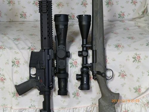

    Those familiar with the Burris Eliminator series, esp. the III, may have the impression it's huge - it really isn't. It isn't small but it's not that much bigger than some conventional scopes of the same magnification. Mine is the 3-12x44, not the 4-16x50 - more about that shortly. Here is the Eliminator III beside a Vortex Crossfire 3-12x50mm. As you look at the pics consider that many scopes have a 30mm tube vs the 1" Crossfire. The Eliminator III is about one inch longer than the Crossfire. Clearly it is bulkier in girth, but that seems to have little impact on anything other than looks.
    How about weight? Well, Burris lists the Eliminator III at 26 oz, but that includes the base and one CR123A battery. I should have weighed it before I mounted it and zeroed it but I didn't . In comparison, the Vortex Crossfire 4-12x50, a conventional scope, (the only choices are 40mm and 50mm, the Eliminator III is 44mm) lists right at 21 oz. Both have adjustable objectives. So the Eliminator III weighs about 5 ounces more than the Crossfire, that's not huge either.
    But what do you get for five more ounces and one inch longer? Incredibility! I was prepared for a disappointing experience; I perceived this to be more of a long range scope. After shooting it mounted on my Diamondback AR15, I have completely changed my mind. I'll get to the shooting pic shortly, but first, the features of the Eliminator III.
