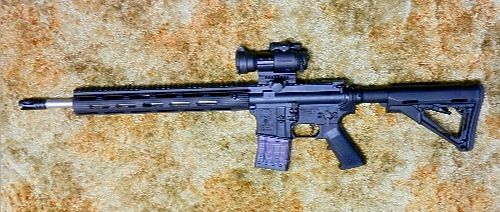

The gun is one I built with a Spikes lower, a JD Machine upper, a BMC bolt and carrier assy, a Wilson Combat 300 AAC Blackout, Tactical Lightweight, 16", 1-8 Twist, Stainless, a Wilson Combat adjustable gas block, and a Midwest Industries SS gen 2 handguard, and a Magpul stock that will soon be replaced with an Ace lightweight fixed stock. The pic below is with a Troy VTAC Alpha handguard instead of the Midwest Industries. I could not get the Alpha to center on the barrel and the MI SS gen 2 is smaller, lighter, and better - I just don't have a pic with that handguard:
