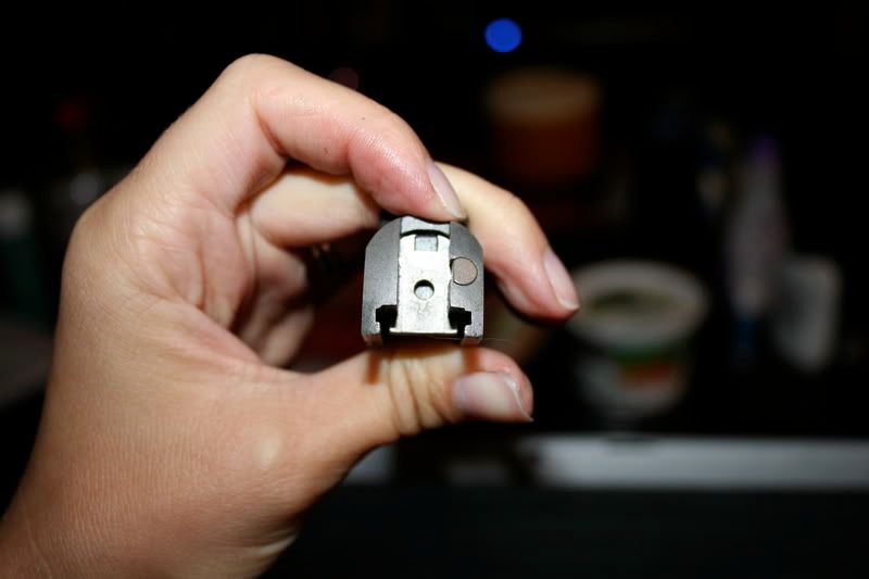

    I have a Mustang myself and what you are describing certainly sounds like extractor problems not the ejector.
    The extractor is very easy to change out and clean.
    You may fix it just by taking out the extractor and cleaning around it.
    In case you don't know how to take out your extractor follow the following steps...

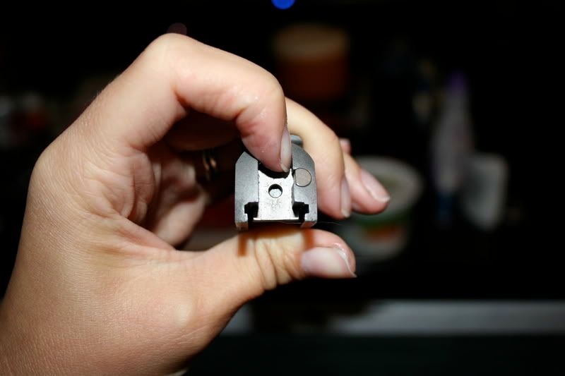

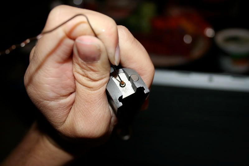

    First, of course, take off the slide, take something small like a toothpick (or like me, a bobby-pin) and press down the firing pin...
    When you have it pressed down far enough the firing pin stop will be able to be slipped down.

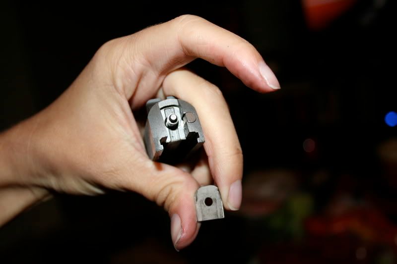

    Slide the firing pin stop down and off (but be VERY CAREFUL to cup your hand over the area to catch the firing pin as it WILL shoot out and you'll have one heck of a time trying to find it again (ask me how I learned this one))...

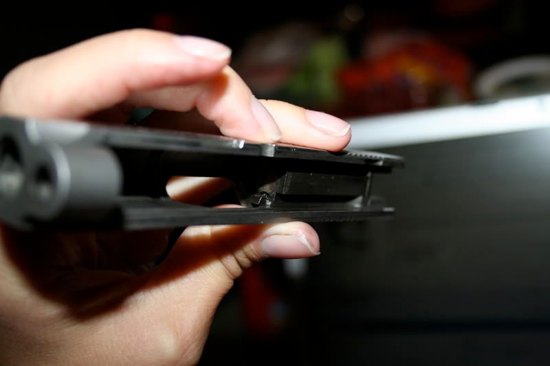

    After that, you may have to push on the extractor from the inside to dislodge it and keep it from hanging up on the slide....

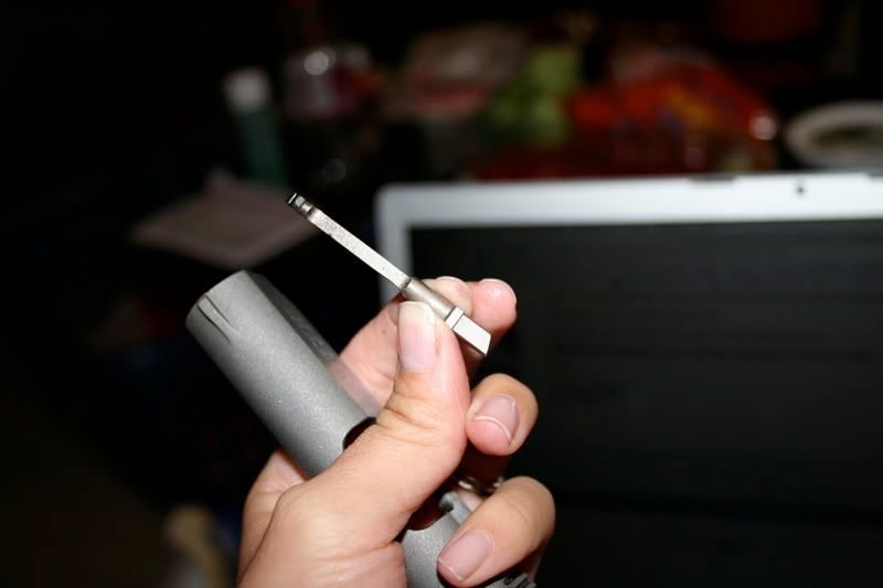

    Next, pull the extractor from the slide the same direction you pulled out the firing pin...

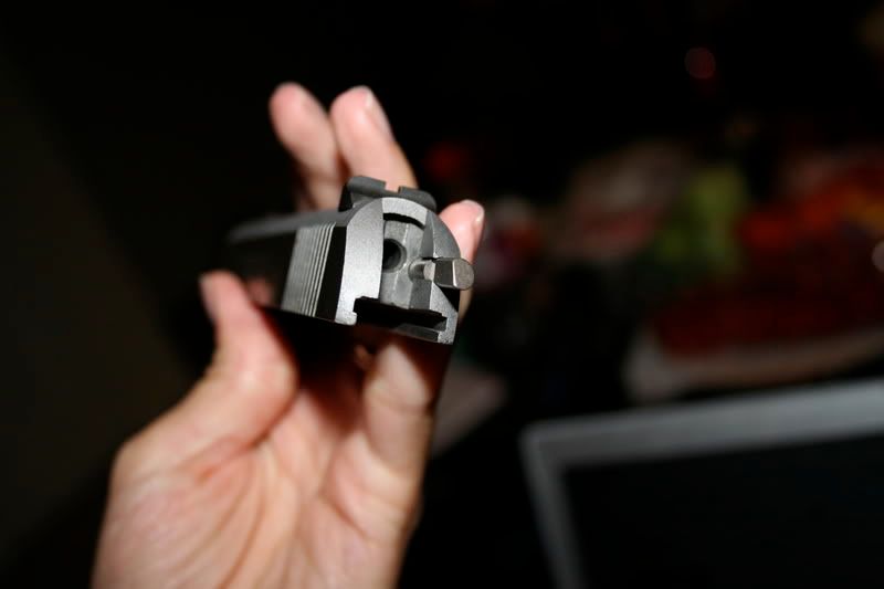

    And HERE is your extractor...
    Forgive the dirt, I went to the range and haven't cleaned it yet.
    If you clean the extractor, take a q-tip and run it through the extractor hole to clean it out.
    Like I said, a good cleaning might be all it needs.
    You should clean the extractor and firing pin every 5-10 trips to the range. Gunk getting built up in there can lead to extraction problems.
    Hope this helps.
