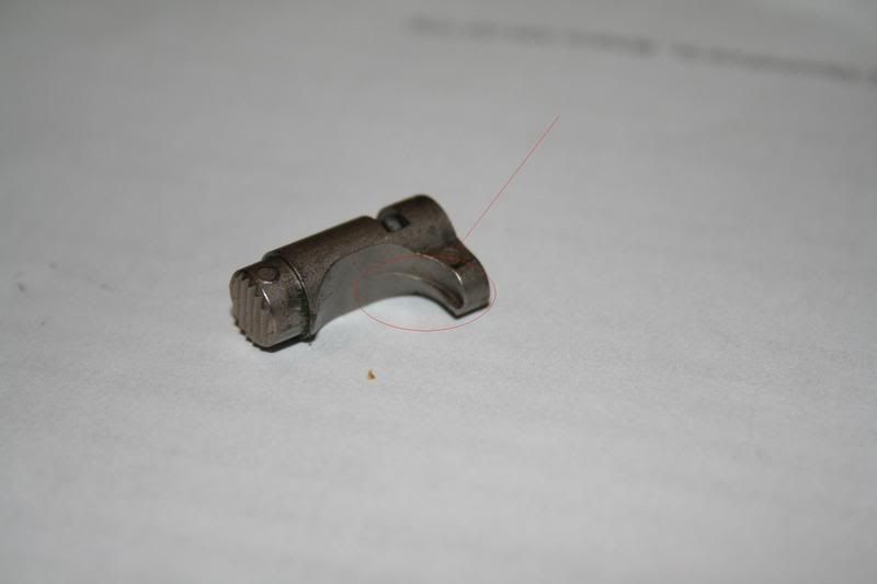

    The mag catch is either worn or you have defective mags.
    The mag tension of a fully load mag will keep the mag in place untill one round is fired, the mag tension decreases, and the mag drops free.
    Remove the mag catch and inspect the ledge that holds the mag in place.
    Standby and I'll get pictures off of my Mustang.
    You can see the little ledge on the right side, I'm willing to bet it's worn down a little on yours.
    Also, if it's not mag tension, it just might be the recoil kicking the mag loose.

    If it is your mag catch, go to Brownells and do a search, they have most parts for Colt .380s
