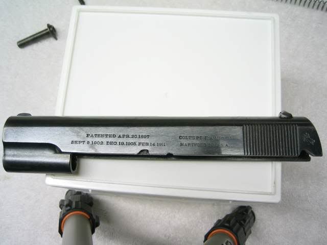

    Does this slide look a little too good to be original blueing? Every old Colt I have seen had lide a more brownish blueing as opposed to the bluer blueing on this slide. Anyone follow me? Maybe a reblue at some time? Either way its still a 1913 army Colt, and I would love to be the owner.

    It's just you. Not sure on the goof blueing. ;)
    Maybe it was well cared for and stored properly? To difficult to tell from that photo.

    I'm certainlt not an expert in gun finishes or 1911 military history, but the Guide Rod in this photo seems to demonstrate bluing. I thought this part was left un-blued from the factory???
    The rear sight in the other photo seems to have the identical tint of bluing found on the slide. I thought sights were manufactured by different company/division and blued before installment??

    A M1911A1 slide on a M1911 Frame, hum. Looks like maybe a armory rebuild.
    Bruce,
    It is an arsenal rebuild, look closely at the receiver just in front of the slide stop, you can make out the AA stamp, AA = Augusta Arsenal. The 1913 looks original to me, but it's not the best of photos and the UMC barrel would bother me.
