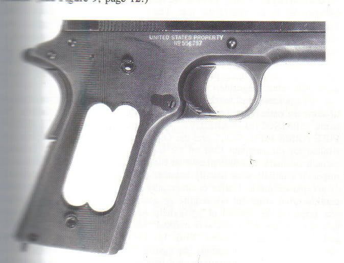

    Hummmm....No Inspector Stamp & No Serial Number.
    Look at the odd location of the UNITED STATES PROPERTY & the location of the rampant Colt logo almost right centered on the slide.
    Colt employees used to build one at home by smuggling parts out in the bottom of their lunch boxes.
    What if you owned this one and wanted to carry it for personal protection?
    Would you have to go to the ATF and have a serial # added to it?
    Actually, those are the correct locations for both on a 1918/19 pistol. The US property marking was authorized to be moved from the left side of the pistol to the location shown in the picture on 5 June, 1918. Colt used 4 different styles of "transitional" slides in 1918. If you notice the finish, that pistol is known as a "Black Army" to Colt collectors. In 1918 the Government gave the OK to Colt to drop the last couple steps in final finishing to speed production, it gave the pistol a dull blue/black look. If you were to remove the stocks, you'd probably find it has the heart shape cut-out too.
    (Charles W. Clawson pictures)
    What if you owned this one and wanted to carry it for personal protection? Would you have to go to the ATF and have a serial # added to it?
    That is still hotly debated among collectors, if the pistol never had one, meaning the pistol wasn't defaced, would it by law need one since they weren't required until the Omnibus Crime Control and Safe Streets Act of 1968? But, Colt pistols have always had serial numbers on them since the beginning in 1836. It would be something I would call the BATFE about (from a pay phone though. ). It being a Colt, it would have had a serial number if it were taken out of the plant legitimately.

    Serial numbers were not required until 1968, unfortunately the problem you run into is, legitimate Colt's have aways had serial numbers, and the BATFE is aware of this fact.
