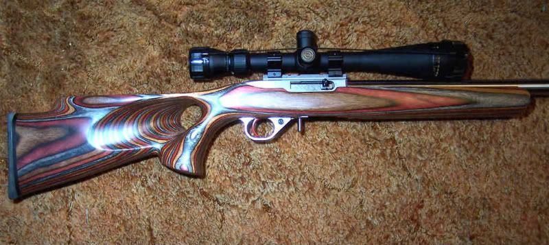

    If I'm reading you right, like me you bought your 10/22 with the specific intent of customizing it. You're in for some fun. First off, sign up on RimfireCentral. Tons and tons of information. Check out their advertisers. Several stock and barrel suppliers. I think the actual receiver on mine is the only factory part still remaining. I went with a Green Mountain barrel but I hear lots of good stuff about WhistlePig barrels also. Another site of interest is Kidd Innovative Design. I have a STI trigger group (no longer made) but Kidd offers virtually the same 2-stage trigger. Absolutely amazing trigger, though I wouldn't recommend it for off-hand competition unless you crank up the pull weight some. About the only thing I can think of that was a complete waste of money (IMO) was the Volquartsen Stabilization Module. I didn't have it on long, though it is on there in this picture:
    When everything goes right, these little rifles are capable of amazing accuracy. Most accurate ammunition I found for mine is Wolf Match Extra.
    You're in for some great fun and great shooting.
