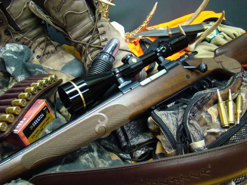

    The only other thing I can add is to make sure the muzzle crown is not dinged up as this will affect accuracy. The triggers are very easy to adjust on the Model 70 as well which is a really big plus but you should make sure someone hasn't butchered it. With the safety off, work the action and close the bolt rather forcefully to make sure it doesn't cause the gun to "fire". Also with the safety on, try pulling the trigger to see if it fires. Try this in the "mid" position of the safety lever as well. If any of these cause the gun to "fire", I would pass on it. It may just have the screws set too light but it also may have been tinkered with beyond that so I wouldn't risk it. Don't hesitate to get one of the new FN made Winchesters either as they are really getting rave reviews on other forums I frequent.
    I have a LH Featherweight in .270 WSM that is scary accurate and my best with it so far as been nine shots in under an inch. Not saying your 336 isn't accurate but once you start shooting a bolt action, you'll most likely become a convert. They really are phenomenal rifles, just make sure you get one that has the pre-'64 features.
