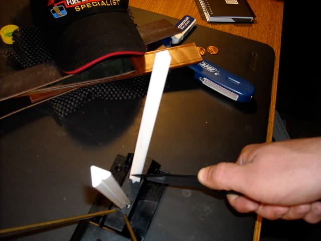

    Now that we've got some basics, let's get to the actual sharpening. You want to start with the most aggressive hone that will remove your material. Pushing harder won't do anything but load it up with stone, and on some stones, just wear them out pretty quickly. The sharpener that I'm using comes with ceramic hones, and has a minimum of 4 steps to sharpen a plain edge (yes, it can do serrations as well). To give you an idea, the medium (grey/brown) stone is about 500 grit, and the white stone is about 1000 grit. The optional diamond stone is about 220 grit, and the ultrafine is about 2500 grit. First get everything setup. Setup for me includes getting the 2 brass safety rods in, and selecting an edge angle of either 30* overall or 40* overall. I use 30* straight on my knives, and put 5-10 passes with the fine at 40* to finish off a friend's knife. For the sharpmaker system, you'll notice the hones are 1/2 inch triangles. First, you put the grey stones in the 30* slots with the corners pointing towards the inside.
    Starting at the hilt of the blade is the most comfortable for me, so that's what I do. Others start at the tip. It doesn't matter. Pulling the blade towards me is just easier for me to control. What we're doing is standing, with the sharpener on a table, looking straight down over the blade. We want to keep the blade as close to vertical as possible. Don't freak out if one side hits the edge before the other - many knives, even expensive ones like Benchmade, come from the factory with one edge at a slightly different angle. Just keep going till you get to the edge. For those of you who can't even come close to freehand sharpening, don't freak out - this is pretty easy to do. The reason why bench stones is so difficult to pick up on is because you can't see the angle formed at the edge. By flipping the stones about 90 degrees, you can see the angle, and it's pretty easy to keep mostly straight. If you're STILL having troubles, put a small 1-2 inch long level and rubber band it on the spine of the handle. Play "keep the bubble in the middle" for a few hours What you DO NOT WANT TO DO is drag the tip of the blade off your hone - EVER if you can avoid it. What will happen is your sharp point will become a dull blunt rounded poking stick.
    Start at the hilt:
    End before the tip gets to the edge:
    This isn't so bad now, is it?

    The reason why we start with the corners of the triangles is simple - less area on the stone = higher pressure on the blade we're sharpening, the faster it moves along - that's even while keeping the same pressure you're using with your hands. Least it sounds good. Remember, don't push hard - let the abrasives do the work for you, especially with this kind of setup. The harder you push, the more the base flexes and the further apart the stones move - and your angle changes. Remember what the key is to a sharp knife? A (fairly) consistent angle.
    Well, now that we've reached the edge (notice how there's no more sharpie on the edge, not even at the very very bottom?), we can move on to a finer grit setup. To do this, simply rotate the stone so you're using the flat part of it. This will take it from the "very very fine hacksaw blade" utility setup to "the toothy knife edge" that works great as a utility finish for most people. Again, start at the hilt, end your stroke with the tip still on the hone. Keep checking your progress on the burr with the light from this point out every x number of swipes (sometimes it's 100 swipes, sometimes it's 2, just depends). When you can get the burr flipping back and forth with very few strokes, we'll progress to the fine stones. There is an added trick besides keeping the blade straight up and down this time. You're also going to watch where the edge contacts the hone to make sure that it's contacting the middle portion for the most part. It's honestly not as complicated as it seems, I promise!!!
    Start at the hilt:
    End with the tip on the hone:
