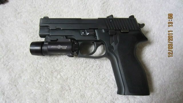

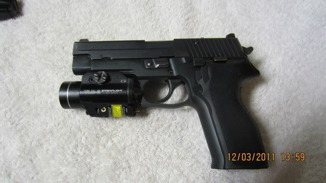

I already had a Streamlight TLR-2 and was pretty impressed with it's performance both as a WML and a laser sight. The tactical light is bright, the red laser is bright and it's easy to adjust. The TLR-2 'tips' on. Most weapon mounted lights (WML) slide on from the front of the rail and click in place. The TLR-2 installs in the position it will be in by kind of rocking it onto the rails and tightening down the mounting screw. That takes longer, but the upside is you don't have to place your hand forward of muzzle - that seems like a good thing to me. Well, let's take a look at the TLR-2 before we get into sight offset. Here's the TLR-2 on a Sig 226R SRT:
Notice two things in the pic: how low it sets below the frame (i.e. the laser) and how far it extends beyond the muzzle. And, the P226 is no small gun! For comparison, here's a Surefire X200 (no laser) on the same gun. Notice it extends past the muzzle a bit more than the TLR-2:
And before I forget it - a tactical issue arose while shooting the TLR-2. The switch on the TLR-2 is a rocker switch at the back of the unit - it's like little paddles on each side. Hang on to that for a minute. I shoot with a thumbs forward grip. On numerous occassions while shooting with the TLR-2 laser, I became aware that in recoil, muzzle flip was causing the paddle switch to contact my support hand thumb, knocking the switch to the off position. That can't be good!!! I've thought of two solutions to that so far - duct tape or cut the last joint of my thumb off. I don't think we use that part of our thumb much anyway.

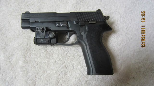

So, that would complicate things for a carry gun - it just makes a large gun larger (longer). Then, here's the Viridian C5L:
It's important to realize the C5L is both a WML and laser. And before we leave size and compactness, let's look at the C5L on a smaller gun - the Sig P229R SRT E2:

If I measure the distance from the laser to the centerline of the bore for the TRL-2, I get 2.75". That means that if the laser is sighted parallel to the bore, you will hit about 2.75" high. That may or may not be a problem. E.g. if you put my upper lip, you'd hit me right between the eyes! :blink: I suspect that would be true for most 'heads'. And it would be a consistent offset. There would be some bullet arc/drop, but out to about 15 - yards it shouldn't be a problem. But there are some other approaches some might like better.
One would be to sight the laser in at a longer range, say 15 yds. So at 15 yds the bullet should hit right where the dot is. As you come back from 15 yds, you'll get that offset again, though not as much as with the parallel laser. I would think this could be a bit more challenging IF you want surgical shots at various ranges, because you would have a different offset as the range changes.
Another way would be to set the laser on at 7.5 yds - half way to 15 yds. That would give you 2.75" high at 15 yds, right on at 7.5 yds, and about 1.6 inches of offset at 3 yds. I guess one needs to try each and see what works for him. I used the parallel method with my TLR-2. How about the C5L.

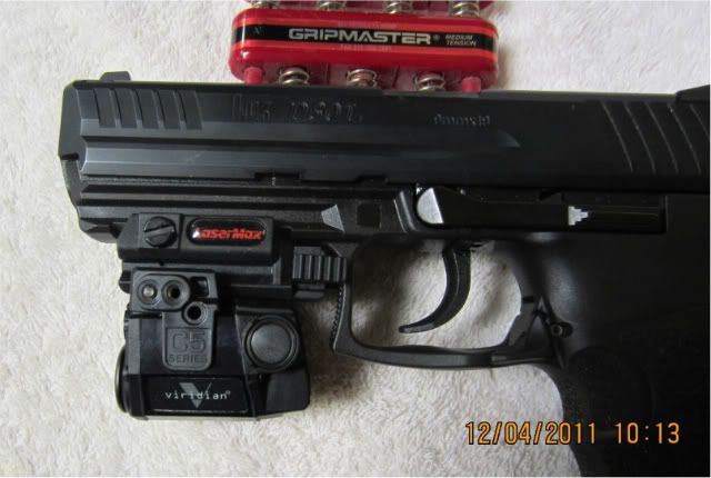

You can see from previous pics that I used one set and it worked on the Sig P226 and P229, no surprise there, but the same set also worked on the Hk P30L. However, I have found a use for the longer adaptor set. Remember the "Two is one, one is none" principle, well here's "two is one":

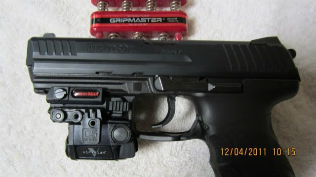

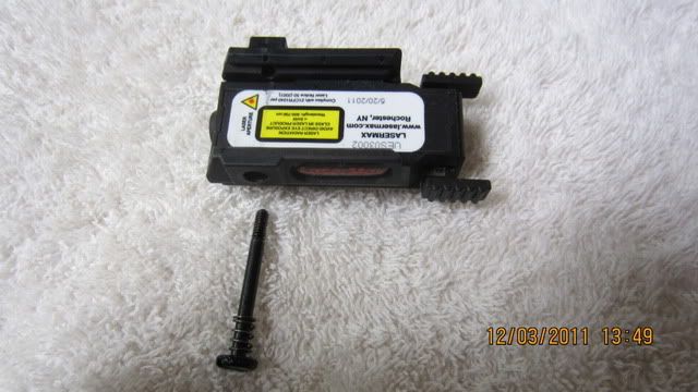

Did you see it! That's the C5L mounted underneath a LaserMax UniMax red laser! Here's the UniMax:
Pretty cool huh!
The reason you'd want to do this is because, you might....well....in case....hmmm, what if.....etc. Actually there might be a couple of reasons, one, "two is one", another is, you'd have a choice of a red laser or a green laser. Why would you want both? That's easy, because you might....well....in case....hmmm, what if.....etc. Well, for me, one would be a night laser (red) and the other a day laser (green). To wit:

I didn't get to try that because I had been sighting in the UniMax another day and the windage adjustment screw quit windaging. NOW HEAR THIS!!! I called LaserMax and was kind of casually told, "Yeah, you over adjusted the screw." It turns out there no stop; the screw just goes in until it runs out of threads and then there's no way to thread it back out. So he gave me an RMA; they're gonna fix it - or more accurately they're gonna restore it to normal, which isn't a fix!
Pretty cool huh!
