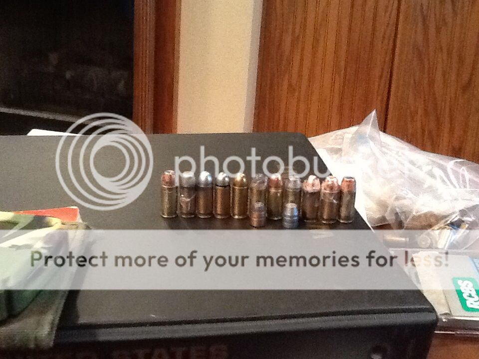

    Some of the concepts I'm considering. Most of the bullets are scotch-taped into empty brass just to give me a look and ensure that COL of 1.10" isn't exceeded, so apologies in advance that it distorts the cartridge appearance.
    L-R:
    1. 90g XTP
    2. 100g Ranch Dog LFP
    3. 102g Lee LRN
    4. 108g Swedish milsurp ball (live round)
    5. 108g Norma FMJ (live round)
    6. 110g Winchester JHP .357
    7. 110g XTP-JHP .357
    8. 115g Hunters' Supply PHP
    9. 115g Hornady FMJ
    10. 124g Extreme Bullets PHP (plated, not designed for SD, but I figure it equates to a LFP)
    11. 135g GDHP-SB .357
    *Not pictured: 125g Lee RNFP
    I figure vels more or less would be:
    90g @ 1200-1300
    100g @ 1100-1200
    115g @ 1100
    124g @ 1000
    135g @ 900
    By comparison:
    MILSURP chronos: 108g @ 1097 (27 shots)
    Norma chronos: 108g @ 1195 (14 shots)
