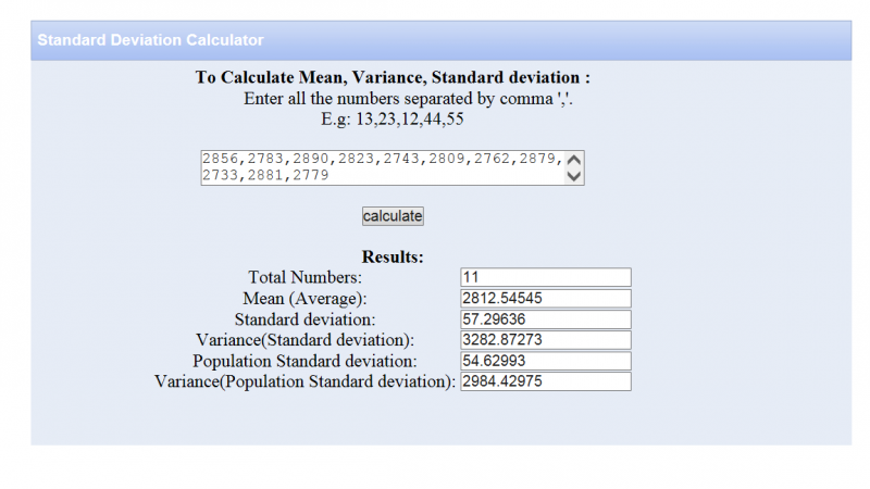

this is un-scientific test I did about 5 minutes ago just posting my results. I just got the CFE yesterday so I'm working up the loads with the CFE, the TAC load is what I've loaded for years. If this helps anybody get started on choosing a powder for a 16inch M4orgey, using common Honady FMJ 55 grainers purchased in bulk. Did chrono two Green Tips not supposed to but I did. One was 2975 and the other was 2991, these where both factory loads.

Ramshot Tac 24.5gr
CFE223=26.2 gr
