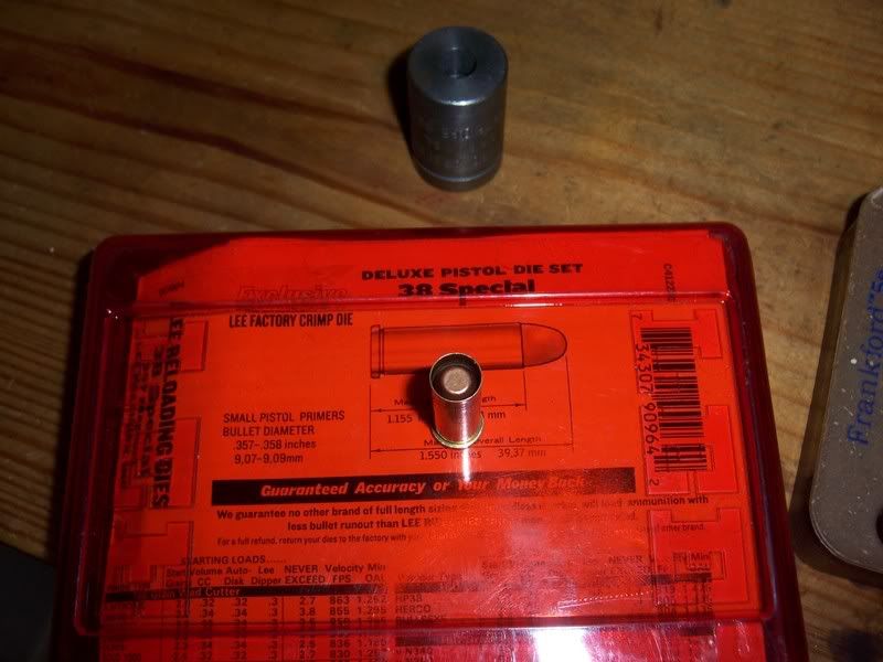

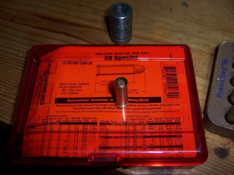

    And bringing back this thread, I just made this booboo because I was distracted while installing the seating die.
    I cannot even imagine the pressure on that sucker.
    Stay alert & pay attention!

    Wow Miggy I've set some deep but never like that.

    Miggy - it happens! Remember my .223 that got over inserted?
    That actually looks like a wildcat round!
