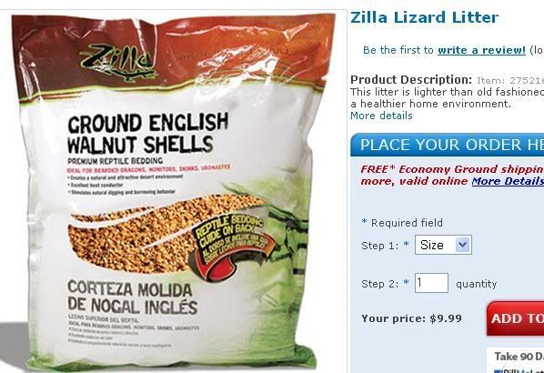

    I went to Petsmart last Friday and remembered to get me a bag of grounded walnut. Although the bag displays only volume instead of weight, I abused the on-premises vet and it is 12Lbs of media for $10.

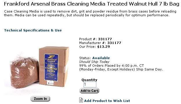

    And Midway has Franford's Arsenal 7Lbs for $13.29
    Sorry Midway!

    I would have never known. Since my wife would never allow a reptile in the house, I would never have thought to look for it.
    I assume they are ground to an equivalent degree?

    Been using the bedding from Petsmart for awhile ... it works. I have actually learned to like it better than much of the pretreated stuff.

    Yes, they are pretty much the exact same thing. I use corncob media for 7mm caliber and larger, but the sub 7mm stuff I use walnut as it is a finer media and is easier to sift out of cases.

    The only difference is that it is not pre-treated but you can go ahead and buy a bottle of MidwayUSA - Frankford Arsenal Brass Case Polish 8 oz Liquid and that thing lasts forever. I still have mine over half full after three years.
