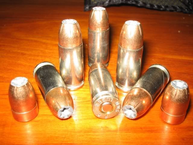

    Finally got some pics of my first reloaded JHPs
    - Cases are Federal nickle coated brass
    - Federal Premium 100 primers
    - Lapua 123gr Megashock JHP

    Pretty!
    Weird hp design though...

    Yeah it is rather strange design, I might shoot some water bottles and see if can retrieve an expanded round and post up pics.
