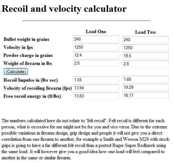

    [QUOTE=alnitak; I also use 2400 (particularly in my .44 mag), and although it is a "traditional" powder, I really don't like it much. It's dirty, doesn't burn completely, and has more recoil than other powders that generate the same fps results .[/QUOTE]
    So, Old Issac Newton ,(and his therories), have been proven FALSE???
    I agree that slower burning powders will tend to leave behind more residue, with a few exceptions. But to state that recoil is less at the same velocity with a faster/slower powder is simply not so !

    Quote Originally Posted by coffeecup View Post
    Sorry, but you're wrong on this one. You'd be correct if bullet weight and velocity were the only factors in calculating recoil energy but they aren't. The weight of the powder charge must also be included. The chart below, created with the recoil calculator at Handloads.com shows the difference. The velocity I used was taken from the Sierra #5 manual using Unique and 2400. Both charge weights indicate a velocity of 1250 fps. Weight of the firearm is a S&W 6" 629. As you can see, free recoil energy for the Unique load (left) is 13.83 ft.lbs. while the 2400 load is 16.17 ft.lbs.
