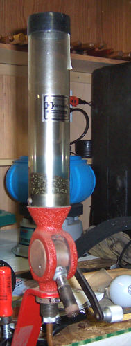

Below is a small pic of my Hornady measure - gets used very little as only needed for rifle reloading. Last time used was year or more ago to do some .243 rounds with N-140 - fortunately not many I am thinking.
Yesterday, changed powder and set it up for N-133 to do some .223 rounds - long overdue. After experiment and weighings - got it set and dropping the 24.5 as I wanted. Proceeded to load 50 rounds.
Today started on another 50 - but after a few powder drops my spidey sense was tingling - maybe cases looked a shade too full by a smidgeon.
Checked drop and - horror - it was up to 25.5 or so (That is above max ). These will all have to be pulled now - and the remaining .243 rounds too (cases had shown some primer flattening but don't think charge had gone too much over - we'll see!).
Cause??? Look at pic and you'll see on the left of the rotating block, what is an Allen set screw, which secures the micrometer measure insert. Ahem - it was not fully tight!
Each time I drop a charge I move the arm slightly a coupla times in the up position to ''knock free'' any grains hung up in the discharge tube. Gradually that had allowed the insert to creep out and so up the drop volume. Glad I checked!!

I have used scoops, scales and trickler (still do for real critical stuff) but have found (normally) the Hornady measure to be incredibly accurate - like +/- 0.1 of a grain at worst - which more or less for plinking ammo is well OK.
That of course is if I attend to tightening up what should be tightened up

Well - all 50 .223's pulled - what a pain in the petootie!!
Seems like the main charge drift really began with the ones I started today and became suspicious of ..... most pulled were close to spot on but a few had definitely drifted toward larger drop.
Better safe but - heck even with a collet puller it's tedious! Yet to check out the few .243's.
