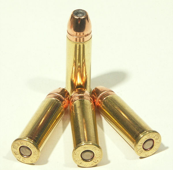

Well - not strictly defensive (other than potentially ) but - in my reloading ''catch-up'' I have reached the stage where I am close to getting done (.454's next then finished). The 800 or so .223's just done should last a wee while.
Got some fired 44 cases reloaded with my near std load with hardcast 240's and also some 240 XTP's, but - decided to make up some heavies. So - 100 new RP cases I have kept aside have been mated with Hornady 300 XTP's ... I know the powder well (N-110) and so have gone ahead with some just sub max loads. They'll be pretty good I think.
Now, the XTP 240's crimping into the cannelure come out just right for OAL at close to 1.6" - so they will be good for the Marlin 94 as well as revo but the 300's which I haven't tried before have a double cannelure. To use the top one and seat for std OAL would probably mean a very compressed charge and they will be for revo anyways.
So, checking my SRH cyl at 1.80", and the Smith 629 at 1.75" - have used lower cannelure which when crimped and done makes them nicely 1.745" - and they'll do good in either revo. No good however for the SBH which is 1.7" cyl.
Always used to load my fave Lyman 250 LSWC's over-long - just for revo use. Anyways - pretty lil devils ain't they! Testing soon as I can get to range - on a cool day. Just another 25 to finish and I'll have the full 100

Thx SOS ........ gotta say that despite the potential lethality of all this stuff, it has for me a distinct aesthetic appeal. Maybe it's just 'shiny things' LOL.
Before loading the 100th bullet I took a pic - the XTP's are rather ''fetching'' Surprising tho how close up, what looked perfect and shiny is in fact blemished, in particular here some of the cannelure areas.
