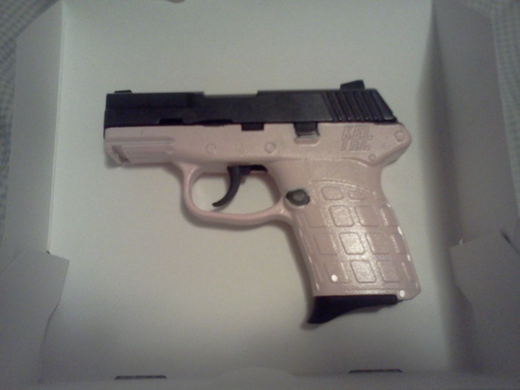

    Quote Originally Posted by AzQkr View Post
    You have a problem with pink?
    This is what my wife made me do to her KelTec PF9 way back when we first got carry guns.
    which may have caused my aversion. LOL
