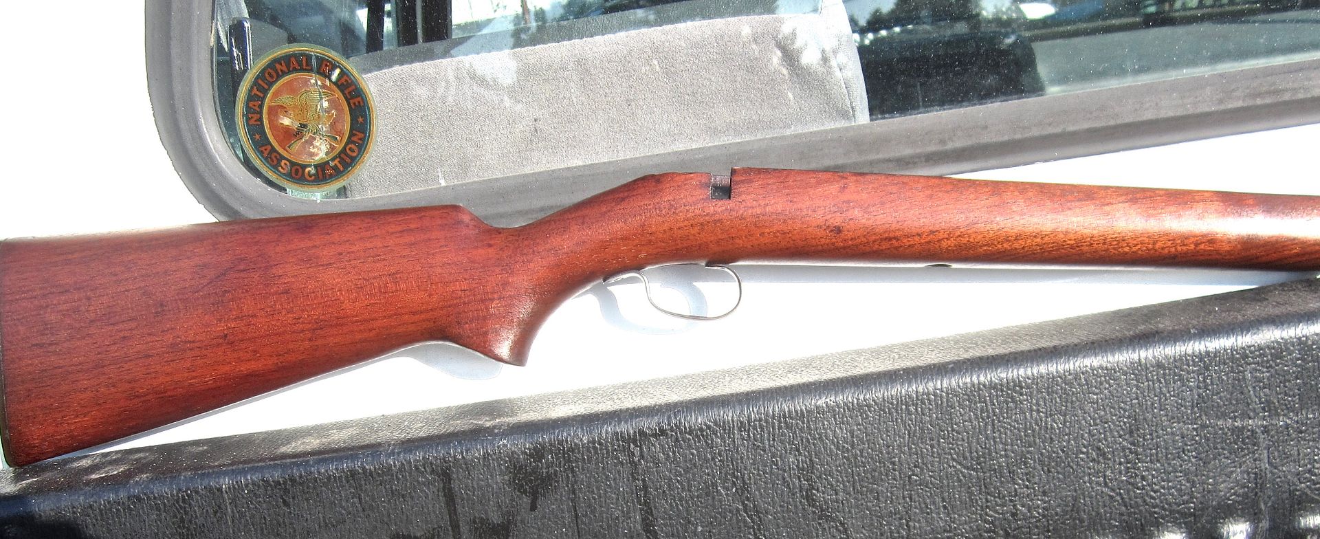

    Anyway, a couple of bolt-action, single-shot .22 rifle's stocks were supplied with a maintenance application of raw linseed oil. Then a bolt-action repeating Winchester Model 72 was trotted out. I'd recently read that some mid-century Winchester rifles were factory finished with wax so I thought I'd experiment with the stock on this rifle.
    We have a house that's nearly 130 years old with a goodly measure of original wood floors we uncovered and brought back to glory. We've been using Johnson's Floor Wax to good effect rather than to employ a modern polymer floor finish. The Johnson's, applied and buffed, really looks great on the floors, I had several cans of the stuff on hand. So, rather than the old faithful raw linseed oil (or flax seed oil if you will), I got out the Johnson's floor wax that we use on our ancient wood floors. Thought to give it a try.
    Slathered it on, let it dry for 15 minutes, and buffed it off. Didn't like the results at all which left the stock with a duller finish than before and with a hint of haze. Should have just applied the linseed oil on a hot stock left in the 100F-plus afternoon sun as I'd first intended to do.
    Didn't really want to darken the stock further and the linseed oil will eventually darken a bit. Liked the hue of the wood as is. The wax kept the hue. Didn't like the muddy-appearing surface though. It's only a straight-grained piece of black walnut, but dulled out like this it just looks ... brown.

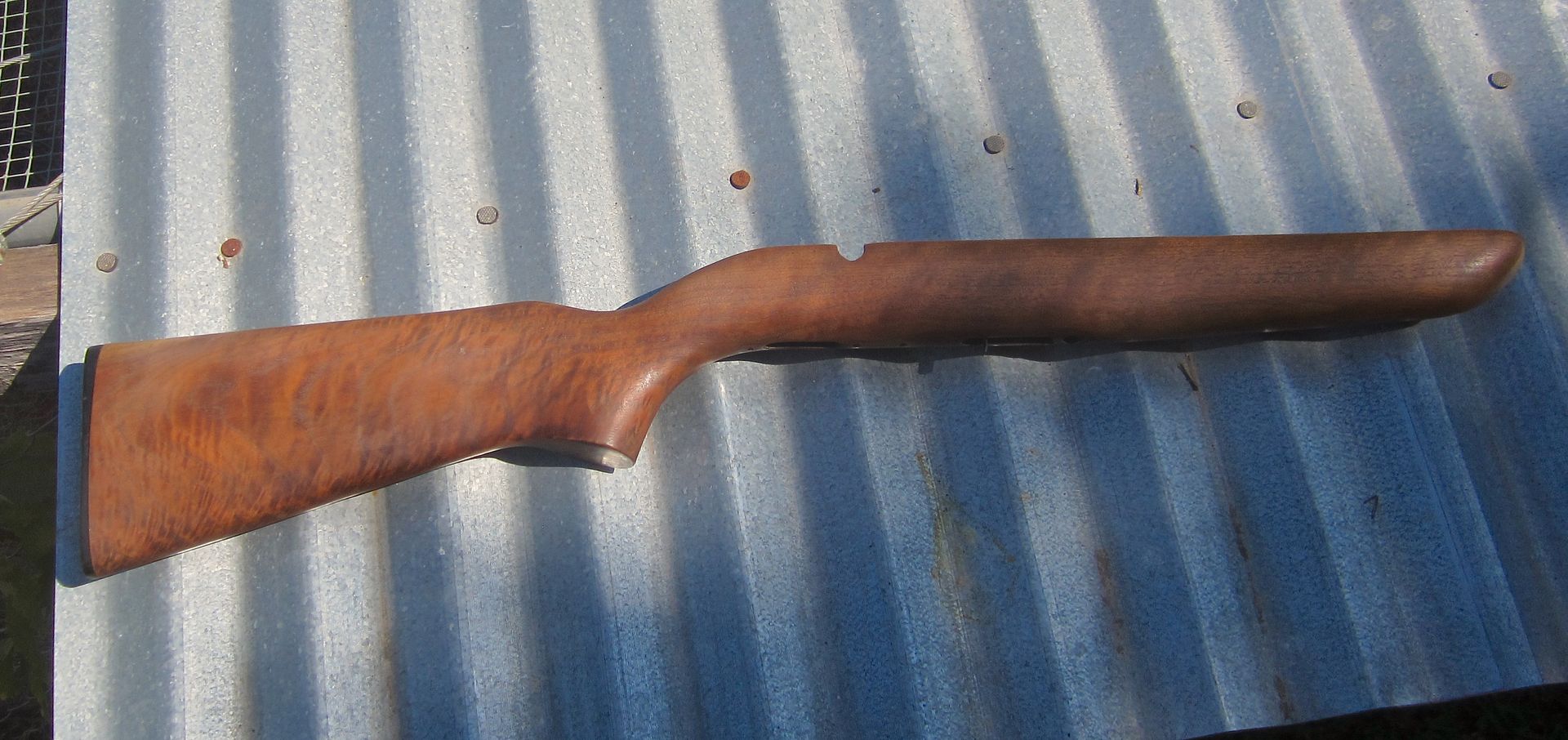

    I retrieved the fortunes of the stock by late last week. This was intended as only a freshening up of the walnut surfaces and not a sanding and complete re-do.
    I cut all the Johnson's Floor Wax off the stock's surfaces with applications of denatured alcohol and gave it three applications of raw linseed oil, allowed to soak for around an hour each on the stock rehabilitation apparatus* and then wiped off excess oil.
    *Stock Rehabilitation Apparatus - a highly technical appliance, being a combination work table and heat applicator. In truth it's a sheet iron awning covering the chicken run with two pieces of crooked cedar limbs lying on it. The sheet iron heats beneficially in the direct August sun and 100F-plus temperatures and the crooks in the cedar limbs are convenient for holding the stocks while being oiled and drying.
    Anyway the stock appears less dried out. Its original surfaces and medium/dark red/brown hue was retained to my satisfaction and wax haze was banished. The camera was fooled and the stock appears a bit orange-y in the very late afternoon sun when photographed against the white cab of the pickup.

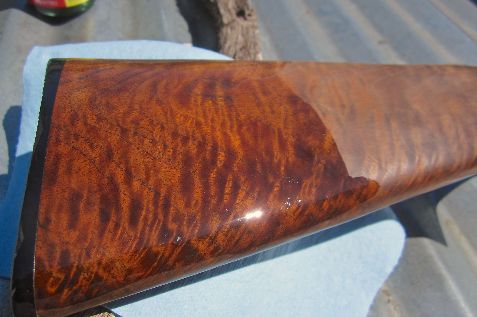

    A really shabby Remington Model 511's lived neglected in the gloom of the back row of the safe. Last weekend, I thought to tackle cleaning up the rifle's stock while I was at it.
    The rifle's nothing to write home about. It has a fine bore, a really outstanding trigger for the breed, and a grooved receiver. Its "LB" code indicates a February of 1955 production date*. I was interested in it because it has the later grooved receiver, good bore, and the nice trigger might make a decent scoped .22 rifle. It's just ... ugly. Metal's not crusty with rust but has turned brown with the odd spotting here and there. The stock was thick with grime and was just ... brown with no wood figure or grain showing. A very well used rifle and very filthy, bordering on being scary hideous. Part of the trash of the "trash & treasures" here and will never be anything else.

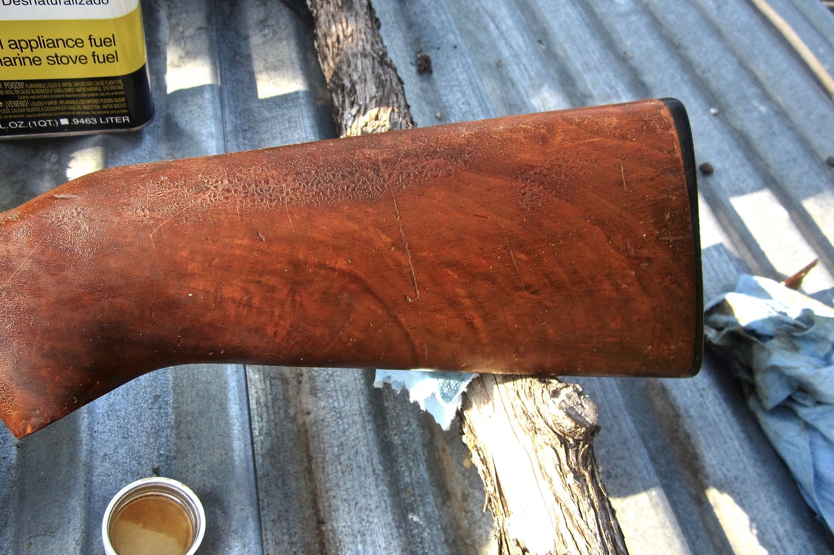

    Cleaned the stock with mineral spirits and denatured alcohol over the weekend. After wiping away the initial application of mineral spirits the wood's character began to just peek through so I thought to photograph it. Wish I'd photographed it before I began for a true "before and after"record.
    The stock's proven to be serendipitous. Who'd a' thought a highly figured piece of black walnut would appear as a factory stock on a plebeian model .22 rifle that listed for all of $26.45 when it was new. It's really not worth so much more than that now.
    But it'll have a knock-out stock on it.
    The stock after the initial layer of grime had been wiped. Crackly crud yet clung and a hideous scratch marred the left side of the stock.
    Prep completed yesterday morning and awaiting the sun to heat things up.

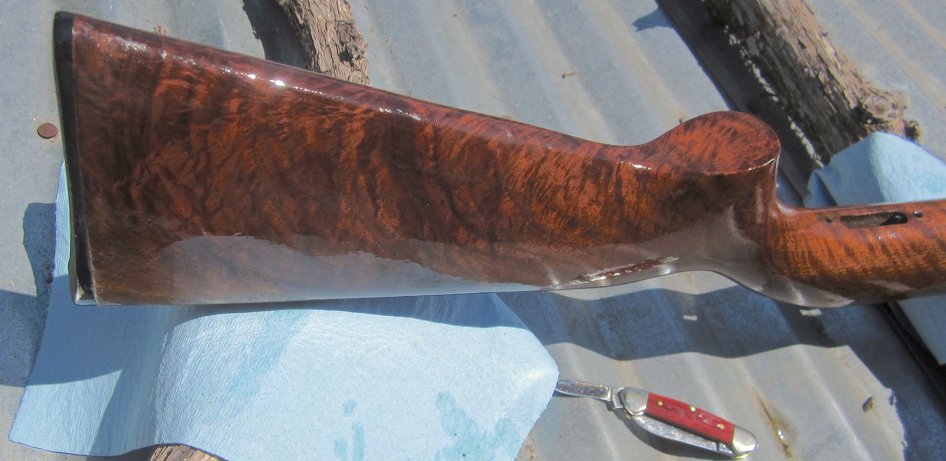

    Raw linseed oil being applied.
    Right side of stock rubbed and heating in 98F and rising temperatures by around 11:00 yesterday.
    Upside down view of left side of butt stock. Look maw! No scratch! The hideous scratch didn't even penetrate the built-up crud layer to damage the wood's surface.

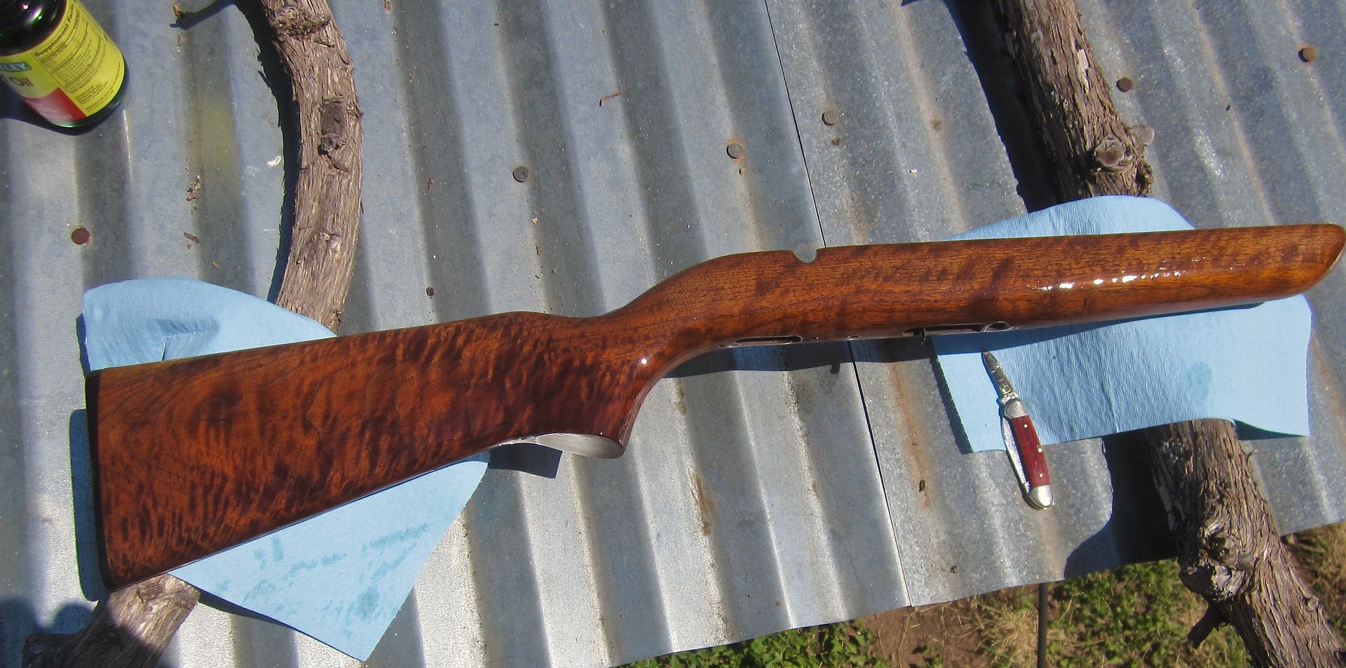

    I had to be away all afternoon so only got in a single application of linseed oil. I'll work on the stock some more this week.
    I didn't intend to do any sanding and filling, but rather only clean and oil the stock. The stock's surfaces were fundamentally sound and could have easily been given a fine finish. I'm staying the course charted though and only oiling the surfaces for now.
    The rifle would look really goofy if the stock was taken to its full potential for glory as the barreled action's finish isn't attractive at all.
    It's funny about that apparently deep scratch on the left side of the Model 511 stock's butt. I figured it was a wound that would require some effort to sand out, yet it dissolved with the coating of filth. Remington's finish on these 500 series .22 rifles left something to be desired too. I guess it was intended to be transparent when new, but a cloudy yellowed effect develops that isn't pleasing after over half a century and serves to obscure any figure that the walnut beneath might display.

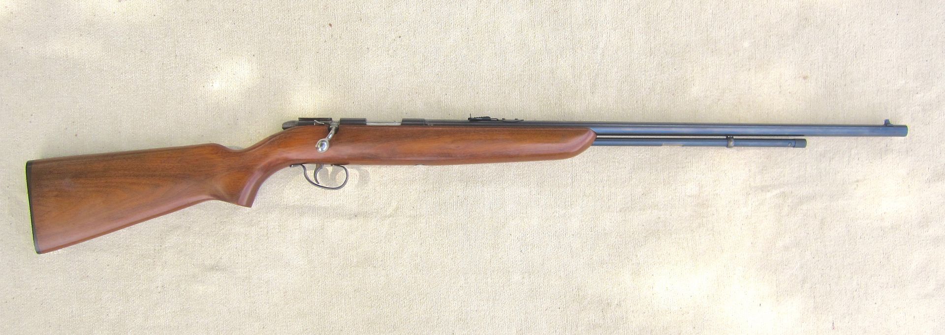

    The 500 series rifle stocks from the 1940s seem to be simply oil-finished walnut. Sometime around 1950 some sort of thick colored varnish appeared. I got that Model 512 back in March at the Abilene gun show. It's stock is a nice original with good clean surfaces. It's not really a pleasing hue though. It's a bit too blond to really suit me. Best description of it, any of several noted on a GunBroker inspection of photographs of 500 series Remington .22s, or this ratty Model 511 is a sort of "baby poop" color. It is fairly thick too as additional scrubbing was required after the layer of gunk came away from the Model 511 stock.
    Here's the nice Model 512 picked up in March, one of the treasures of the menagerie. It was manufactured in February of 1950 and has the later style finish, whatever it may be.
    *Remington Date Codes - Remington Manufacture Dates
