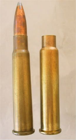

    I piddled with annealing a few times in my younger days. I was wanting to extend the life of my precious supplies of old pre-war .405 WCF brass. Another time I annealed some cases when making the wildcat .303 ICL Improved out of .303 cases. Tedious and never was certain I actually accomplished anything.
    A pre-World War II factory .405 WCF cartridge next to a generic factory .308 Winchester cartridge
    .303 ICL Improved and parent .303
    I've decided that life is too short to devote a lot of time to annealing cases for my purposes.
