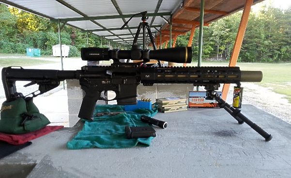

I shot the target you are about to see yesterday at 200 yards with an AR with a Seekins Precision 10.5" barrel, a Leupold VX-6 3-18x scope and a Vortex Razor Gen II 1-6x scope, a Trek T suppressor (that kept coming loose), and an ATF approved SBR lower. I have tuned the first stage of the Geissele SSA-E trigger to my preferences. I'm leaning toward a Geissele National Match DMR - I really like all the adjustment. Anyway...
Here's a pic, actually two pics of the gun. There are, or have been two versions with the only difference being the handguard. The first pic is with the 12" MI SP handguard, and the VX-6 scope.

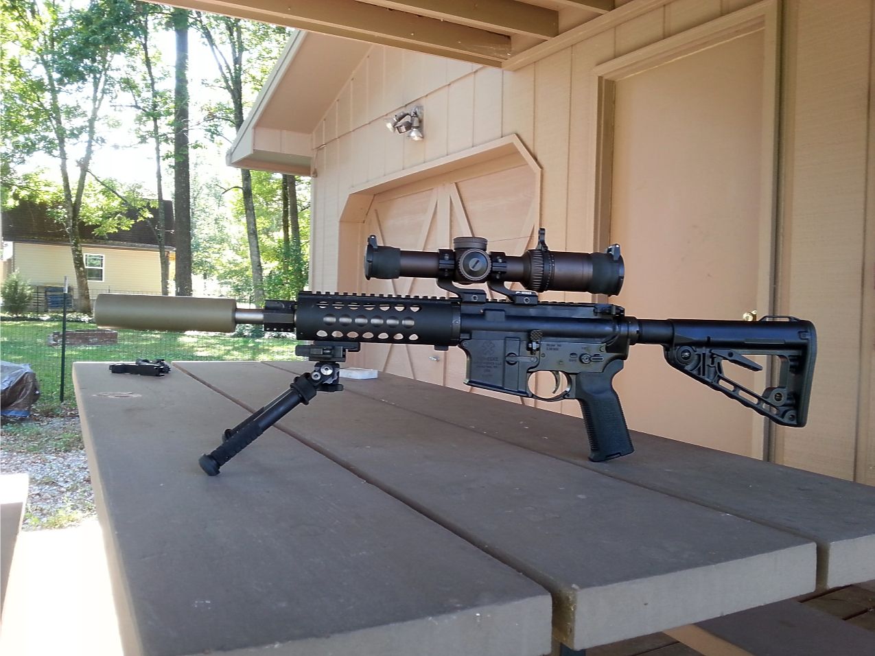

Fortunately, I had a pic of the other version and it not only had the Razor scope on it but the other handguard as well. I went from this version to the SP version (above) and now back to the one shown below or at least a version of the one shown below. This is going to evolve into a sidebar - can't help it, but,
I try to use JP Enterprises adjustable gas blocks. I've used Wilson Combat, Syrac gen I and IIs, SLR, and Seekins Precision adjustable gas blocks - they all seize up - all of them, repeatedly seize up - all but the side adjusting JPs! In addition, the JP side adjust is far easier to assess than the end adjust types, DEPENDING ON THE SPECIFIC SET UP. I replace the set screws that come in the JPs with Allen head cap screws. You can apply more force, the heads won't strip out as some set screws have the tendency to, it's easier to get the larger Allen wrench in the larger Allen head cap screw. The JPs have never seized up on me.
Now about that "...depending on...". If the handguard covers the gas block, it can be difficult, and if a suppressor is in place it can be practically impossible to adjust a gas block from the front. Likewise with the wrong handguard, it can be impossible to adjust the JP side adjust because the adjustment screw is covered by the handguard. Which brings me to why I switched back to the MI SS type handguard. Although in the pic below, the handguard does not cover the gas block, I have one coming that will. The reason I want a longer handguard is the short ones don't give you much room for your support hand, and they give no protection from the hot suppressor. It turns out that in the longer MI SS handguards one of the holes lines up right at the adjustment screw in the JP block. You simply poke an Allen wrench through the hole and adjust the gas!
So this gives me the option of a short handguard as shown, a longer one that would extend close to the suppressor, a longer one that would cover about half of the suppressor, and yet a longer one that would cover almost all of the suppressor. The only reason I don't use that last one is because you can't install, remove, or tighten the suppressor - there's not enough suppressor exposed to grip it.
Since all of these mount the same, all that's required to change one out is to remove a set screw on the bottom, loosen the lock ring, and screw off the handguard. The next one goes on the same way.

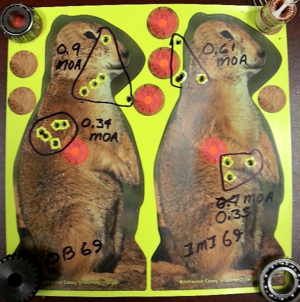

The pic below is one of the targets I shot yesterday at 200 yards. I shot two different types of ammo, different brands but both Serria MK BTHPs, one was low velocity, one was significantly higher velocity. Basically the left doggie was shot with the low velocity and the right doggie with the higher velocity. There are 3, 4, and 5 shot groups - just depended on what ammo I had left at this point. Both bodies and the head of the right doggie were shot with the VX-6 3-18x scope. The head of the left doggie was shot with the Raxor Gen II 1-6x.
It is interesting that the head shot on the left doggie, shot with the 6x scope is almost 3 times larger than the body group shot with the 18x - 18x is 3 times bigger than 6x - wonder if there's a message there???
The average group size for the three groups shot with the 18x is 0.43 MOA. And the 0.9 MOA group shot with the 6x isn't bad!
I am convinced that some one with younger/better eyes could do better than this - I could see eye issues and just had to deal with them.
So in conclusion, with the right scope, right ammo, and right barrel, SBRs seem to give up no accuracy as compared to their longer counterparts. However, this was a windless day; on a windy day, the longer barrel should be observably more accurate due to the higher velocity and shorter travel time.
