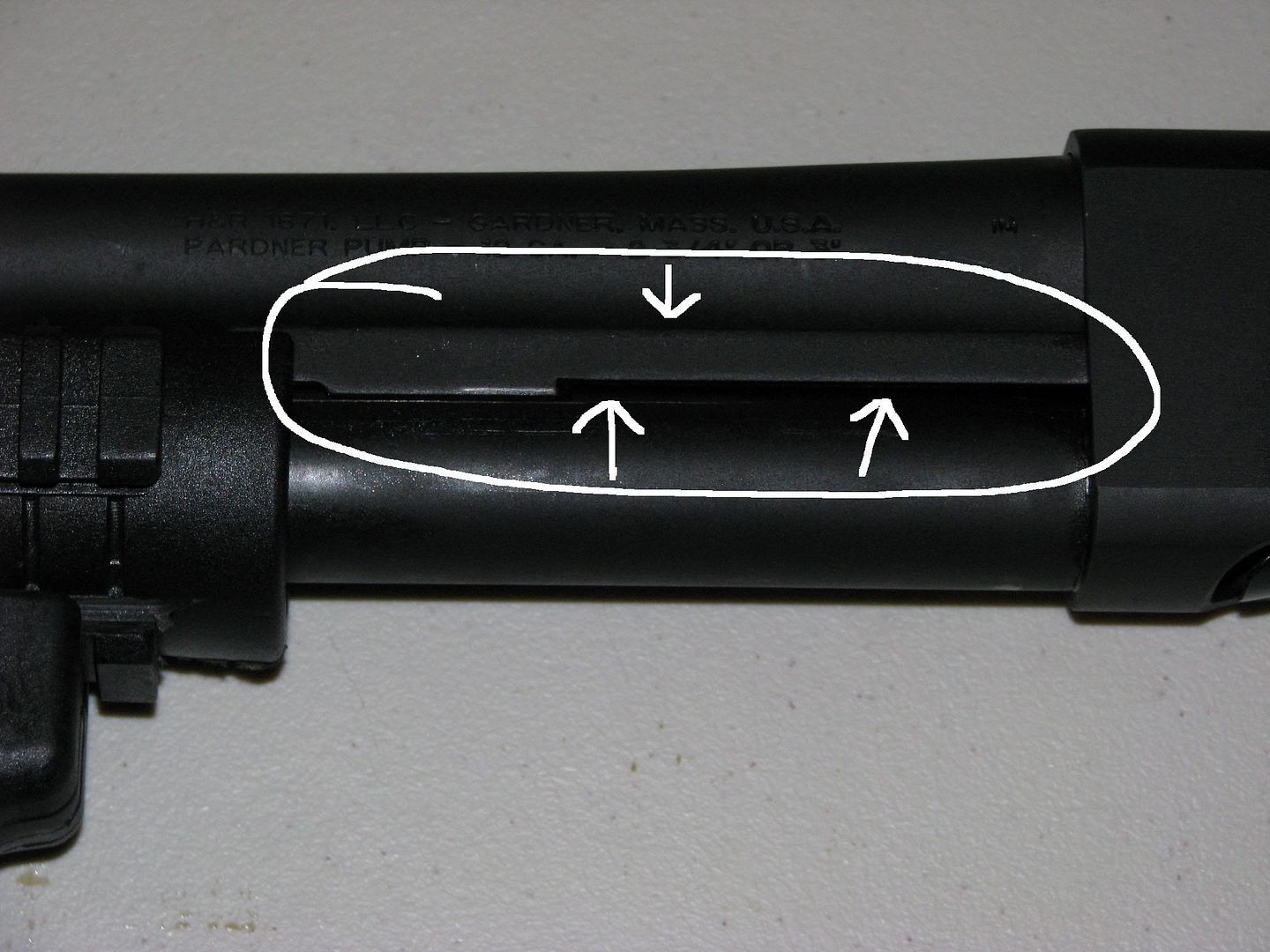

so i put a new forend on my pardner pump. but now i notice a slight amount of action bar assembly wobble. is this OK? the forend is on quite tight. but it seems now since i put a forend grip on there is the wobble maybe i just didn't notice it with the stock grip on due to its ridiculous length? the pic below outlines what im talking about. sorry for large size.

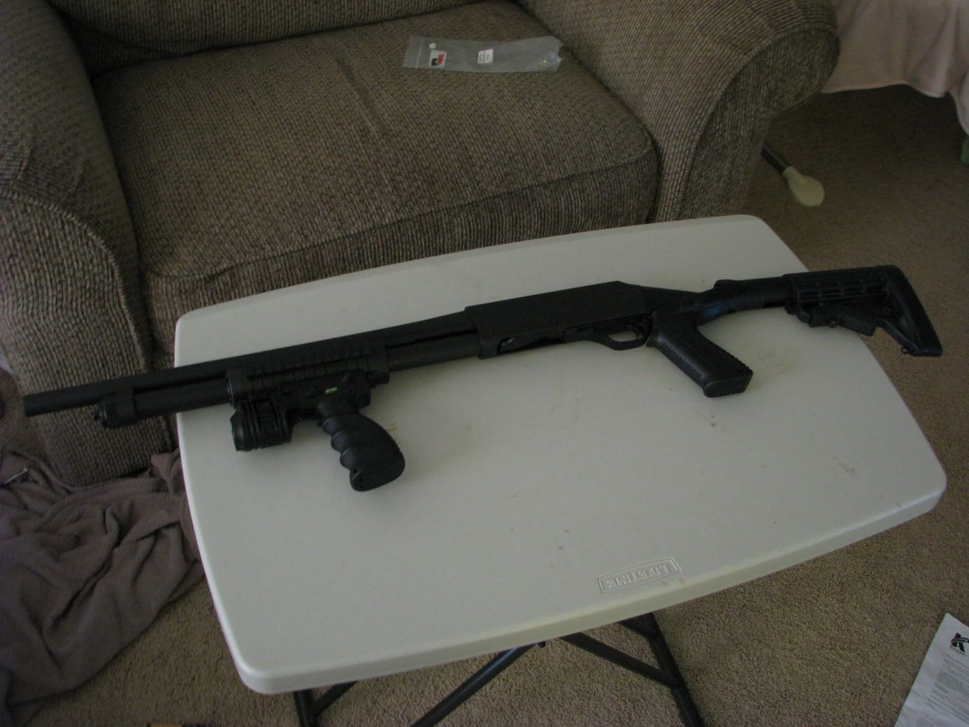

this is a pic of the whole setup so far..

I'll bet the wobble is from side to side rather than up and down which may indicate twisting or binding of the bar(s) in the channels. Usually, the installation of a vertical foregrip accentuates this because we have a tendency to twist our hands as we cycle the action. Use a good quality grease (not oil) in the channels and that should take up a lot of the slack. If not, remove the forend and check to see if the action bars are bent or out of true.

Not much of a problem really. Aftermarket stuff is designed to fit a wider range of models most times. The slack means the inside diameter of the fore end is larger than it needs to be. I have a ProMag tri-rail fore end I would have sold you cheap had I known.

Not to be rude, but your aftermarket parts cost more then your rig! haha. It looks pretty cool.
4,469 Posts
Looks nice.
I love after market parts. My 870 is loaded down with them.
