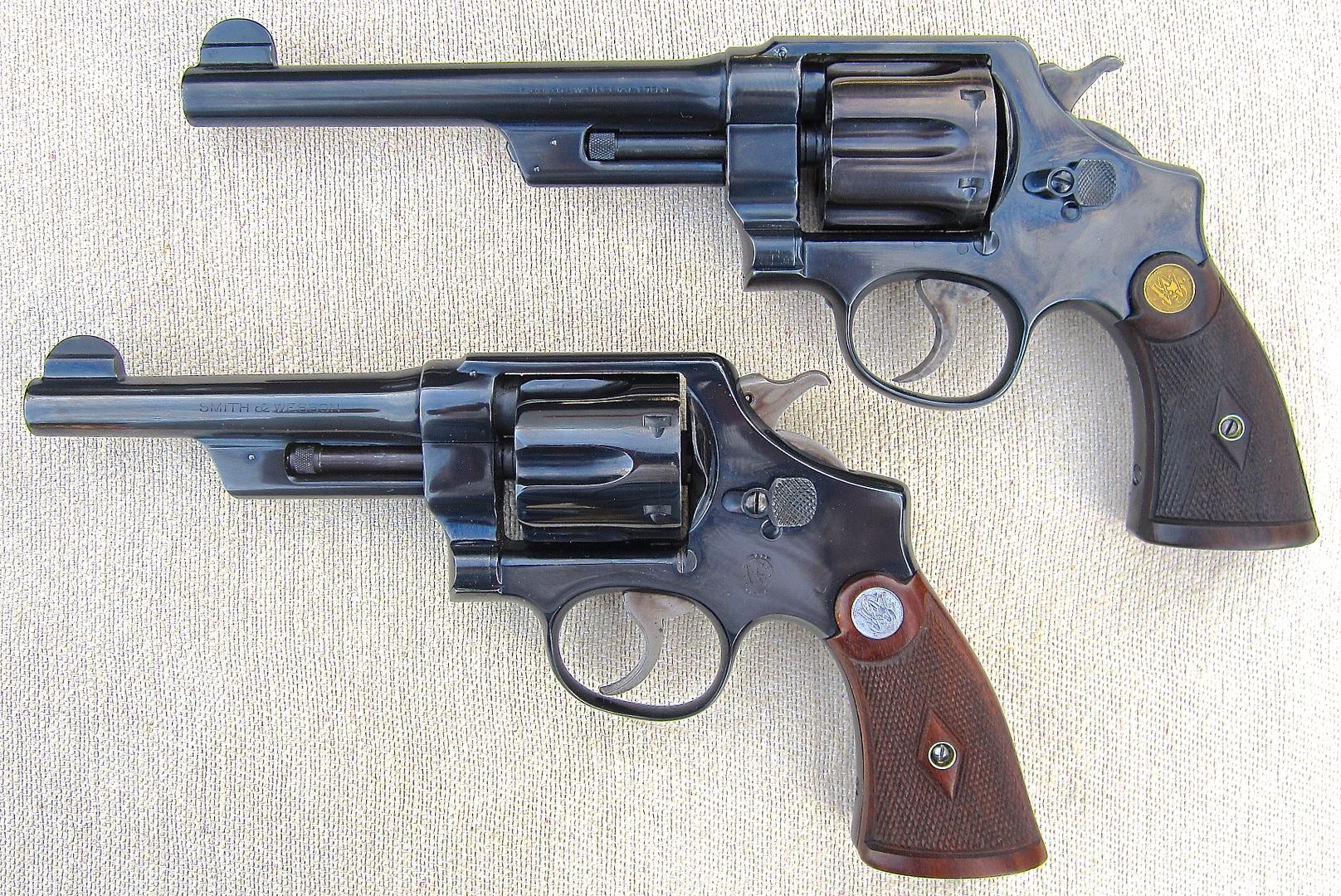

Keith is said to have taken up with the .44 Special when his experiments with heavily loaded .45 Colt revolvers resulted in blown guns. The .44 Special provided more "meat" around the cartridges in its cylinder. I suspect that .44 Special revolvers were blown too in the enthusiastic pursuit of big bore performance excellence. Keith used the early pre-World War I Smith & Wesson Triple Lock, the original N-Frame revolver, pronouncing it to be the best revolver ever produced and amply strong for his experimental loads. Wonder how many he busted? Heat treating advances developed during World War I made the later Smith & Wesson N-Frame .44s of the 1920-1940 period more suitable for such experimentation. The other popular revolver for .44 Special load development in the day was the Colt Single Action Army, either factory chambered for .44 Special or more often reworked and sometimes "reinforced" with "home engineered improvements," to chamber and shoot the cartridge of their fancy. Keith and some others gravitated to some extent to the Colt Single Action Army for their .44 Special performance work. A small number of Colt New Service revolvers were made for the .44 Special and likely saw experimental use, but it must be remembered that Colt and Smith & Wesson did not like chambering their revolvers for the competitor's proprietary cartridges. One sees few New Service .44 Russian or .44 Special revolvers cranked out of Hartford Connecticut and he will see even fewer Smith & Wesson N-Frame revolvers chambered for .45 Colt coming out of Springfield Massachusetts in those pre-World War II years.
Top: Smith & Wesson First Model New Century "Triple Lock" w/6 1/2 barrel from 1910
Bottom: Smith & Wesson Third Model, Model of 1926 w/5-inch barrel from 1931

Yes maxwell97, the Model 1917 is the U.S. military contract variant of the Second Model N-Frame that took up where the Triple Lock left off.
The commercial N-Frame .44 Special of the era would have looked like the U. S. Model 1917 except the commercial model would have featured checkered walnut stocks with large gold medallions and been roll marked with the .44 Special caliber designation. After 1920, the medallions were deleted for a decade to return as large silver ones in the 1930s.
Don't have a Second Model .44 Special, but have a line on one with factory target adjustable sights if I gather the funds. Here's a older photo of the M1917 kept around here. It'll have to serve as an example of the Second Model. Notice the lack of the shroud for the ejector rod.
