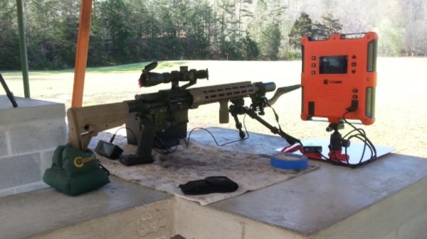

This was shot with a SBR consisting of a BCM 11.5" LWE barrel with an Adams Arms piston, and a Liberty Triumph suppressor. Here's a couple of pics of the gun and the set up:
Oops, wait that's the pre-setup pic. Here's the setup:

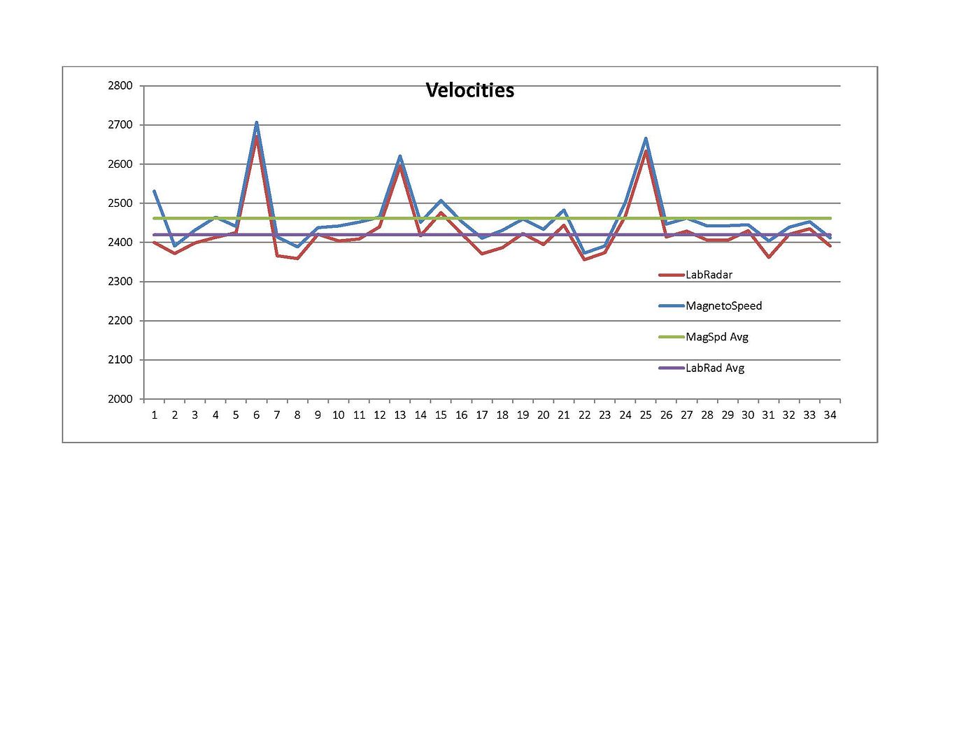

Here is a graph of the velocities I collected with the two units. Actually, I forgot to arm the LR on the first shot and to keep from having a "0" for the first shot, I edited the "0" to a velocity "in the neighborhood".
What you're looking at is a plot of the two velocities; you can see they essentially track but with an offset. There is also a line for the MS average and another line for the LR average. But of immediate interest is the three peaks - why are they there? And notice BOTH chronos show the spikes.
The average for the LR readings is 2420 fps. The spikes are, shot #6 = 2671, shot #13 = 2595; shot #25 = 2633. Those peaks are 251 fps, 175 fps, and 213 fps respectively above the average.
I can't say that I've seen such deviations in velocity with this ammo before. I am immensely glad I was running two chronos or I would have to suspect chrono error - but they both show the peaks, so...
Could this be as simple as the factory got three rounds a loaded a little hot in this lot? Or is this typical?
I can guarantee you I'll be chrono-ing all my HPR ammo for a while - every shot!
Next is which chrono is more accurate? LabRadar specifies an accuracy of 0.1% - that's right, one tenth of one percent. And MagnetoSpeed claims near that accuracy as well, yet the two vary in % difference in measurements anywhere from 0.61% to 2.11%. Which one is right? We may never know.
But this does reveal that ammo can have exceptionally high velocities that we may not know about when we're shooting it.
