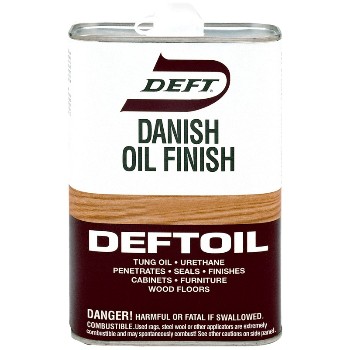

I've never done a laminated stock, but have done a few others. I really like Danish Oil, hand rubbed in with varying degree grit wet/dry paper. If the wood is already slick, start with 1200 for the first two or three rubs (one per day), then move to 1500. You want to work the sanding dust, what little there is, into the open pores of the wood with the oil. That really seals the surface. By the time you've done 8-10 rubs, the wood surface will be almost like hard rock candy, and won't have that "plastic" look. Just a deep luster.

QKShooter is most likely correct about the laminate material. As I said, I have not tried to work a laminate stock, but I do have a newly acquired M77 with a Boyd's stock that I am considering trying some oil on. I figure the Danish oil with 1200 wet/dry can't hurt, and may even bring some luster.
