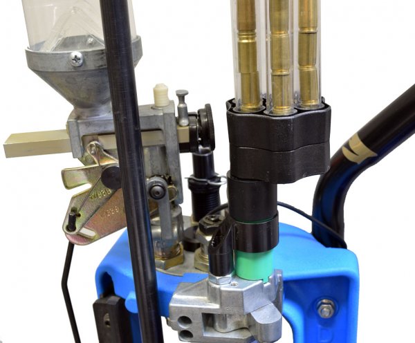

For more info on that, in an optimal world, Id have a case and bullet feeder. That being said, the ones with the big hopper that you dump bullets and cases in, and need different conversion kits for different calibers, bullet types, more electrical outlets, giant hardware thats way up in the air, mirror setups to see down inside them, etc. No interest in that, Id rather feed bullets and cases manually before I had a setup like that. What I do like the idea of is something like the Mr Bullet Feeder product, where you just have a magazine setup with multiple tubes, that you can pre-load casings into. Ive found one that Double Alpha makes, and it seems to meet my requirements. One of the reasons I originally went with the Lee is because of the case collator and feeder was the type I wanted. This seems to be the same, just a higher quality. This is the product for anyone interested.
