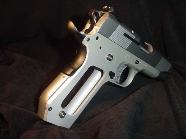

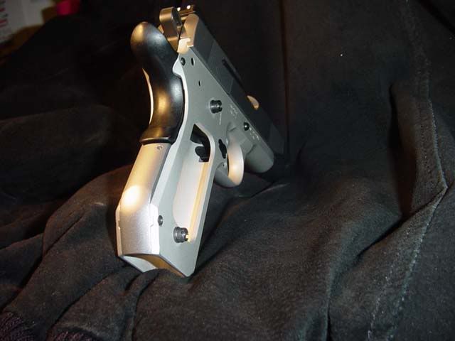

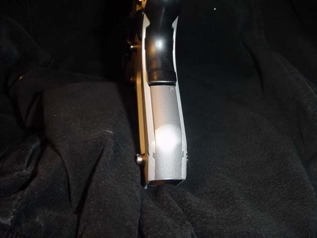

Just finished the bobtail and trigger work on this S&W Scandium commander. Customer wanted a smooth stainless MSH and I am happy with his choice. Looks very nice. Polished all of the trigger internals and with the sear and hammer work, now has a very nice lighter side of 4 lb trigger that is much crisper than the original. Pretty creepy before. I will be cutting the grips to match tomorrow, but thought you might like to see the skeleton. Enjoy.

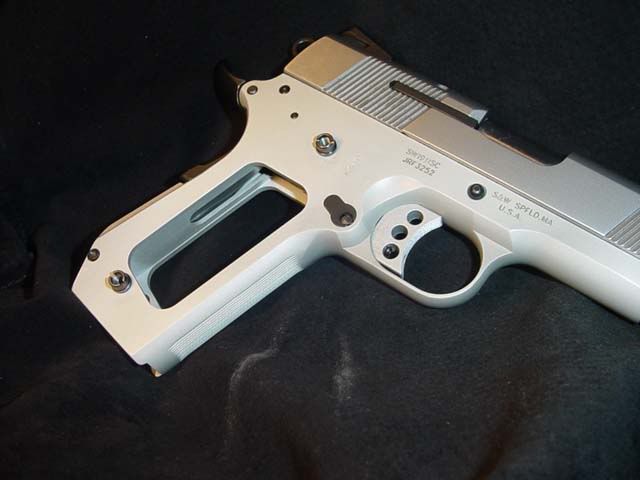

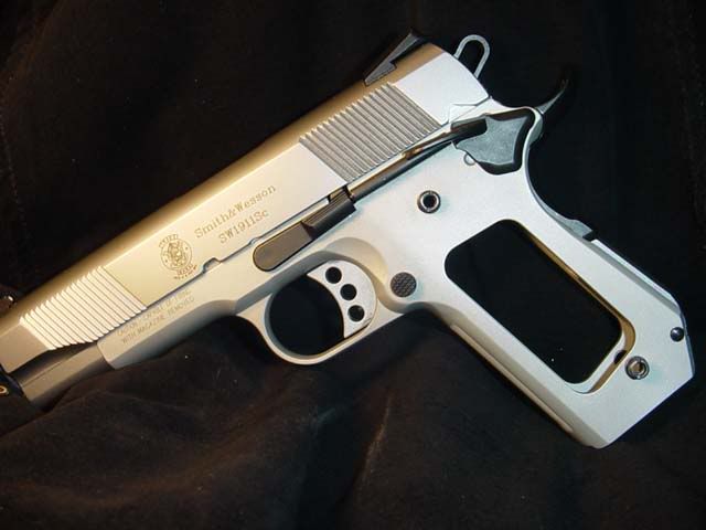

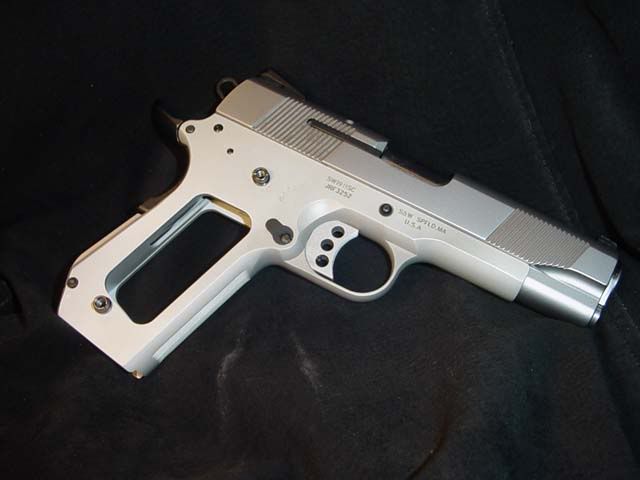

I just finished the gun and the pics. I have a LOT of pics of it as I was playing with lighting and so on. Not that this gun needs this many pics, just a lot of a gun and me playing with the camera. Sorry for the number of them, but enjoy!! The grips were fun to do, not easy and they turned out well. I also replaced the blued MSH pin with a stainless one for a more seamless, blended look. I don't like bobtail grips that are drilled for the MSH pin, I think they look better without.

I noticed that when I was looking this pistol over that the barrel crown seemed to be a bit rough from the factory. It had several significant "snags" that you could feel with your thumbnail running it across the crown. Since the pistol was already here and the owner was agreeable, I did a crown and polish on the barrel before it goes home. Here are a few more pics.
Please excuse the fuzz and polishing/cleaning residue on the gun. I did not get it as clean as I would have like for the pics, but it has more of the used "lived in" look this way. This is one that I would not mind keeping myself. With the bobtail and weight of the Scandium frame and commander size, it makes for one tight little carry gun! I really need to work on the gallery for my website, but at least photobucket is a fast way to post for now.

What did you use to refinish the frame after doing the bobtail.. I have heard lots of places wont fool with them or other lightweights because they have no way to re-anodize the frame
