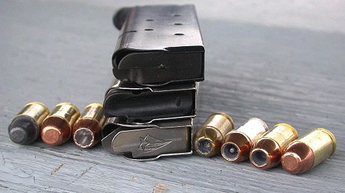

The pistol digested just under 1000 rounds of assorted handloaded CRN and CSWC rounds as well as many types of factory ball and JHP ammunition. It never failed to function properly. While I greatly appreciated this, the pistol had a fairly tough and gritty trigger pull. In short, it was unacceptable for best work.

This pistol has worked perfectly with several different makes of magazines and ammunition since the first shot.

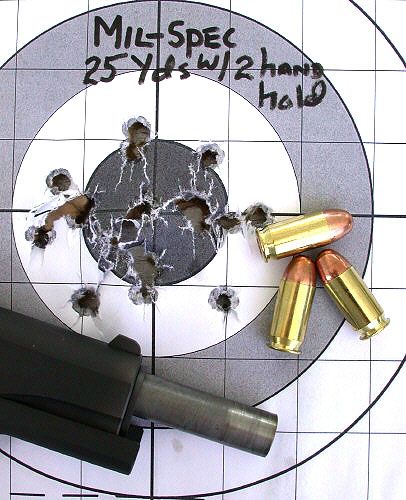

My Mil-Spec shows centered firing pin strikes and the fixed sights are dead "on" for me at 15 yards. During a recent range session with a friend in which we were trying out a new SWC bullet, I got 50-yard groups approximately the size of an open hand. Most of that error was mine and not the pistol. Certainly this is not match gun accuracy, but this pistol serves 99.99% of what I believe I need in a "carry gun."
This slow-fire group is certainly not up to winning bullseye matches, but even with my human error in the mix, I think it demonstrates at least ample accuracy for the majority of us under field conditions.
