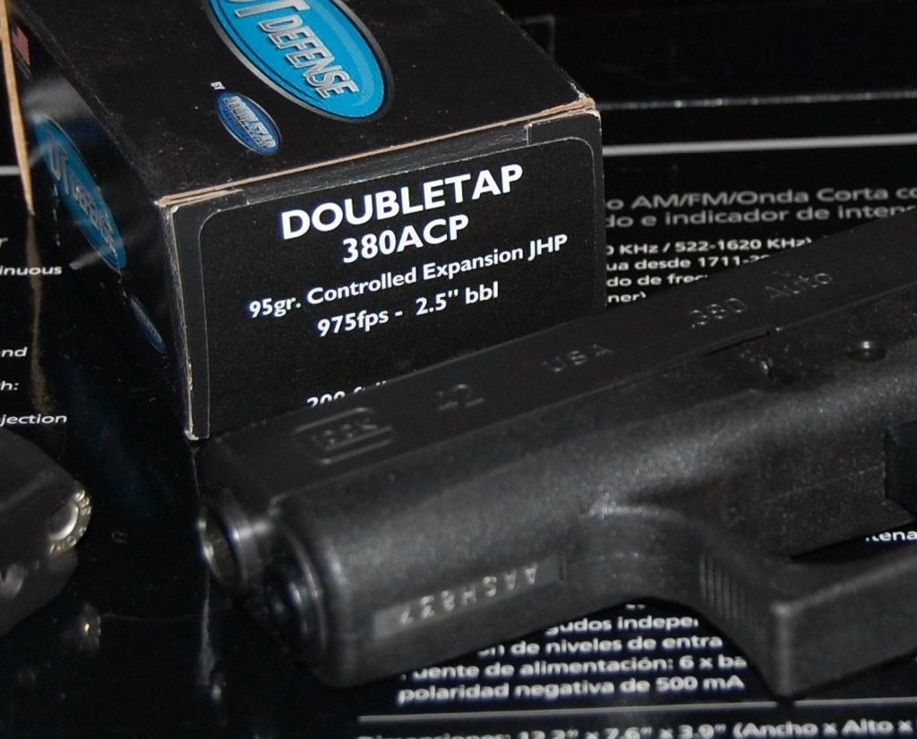

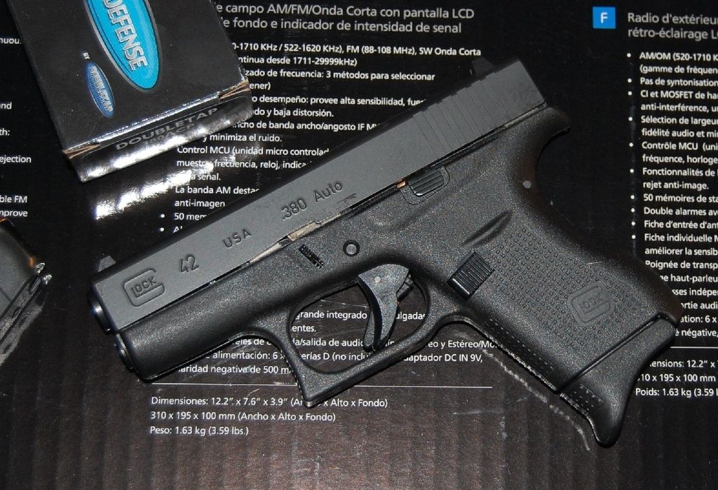

Glock 42.
Reliable and soft shooting.
You or her might not like .380 power, but it's better than a 9mm that won't run 100% with even
practice ammo.
I still think that a G26 is better than the G42 or G43 for belt carry, but am also considering the Glock 39...
as I love the Baby Glock sized guns and that BIG hole in the end is pretty cool looking.
I already have a bit of .45 GAP ammo that's sitting idle:)
